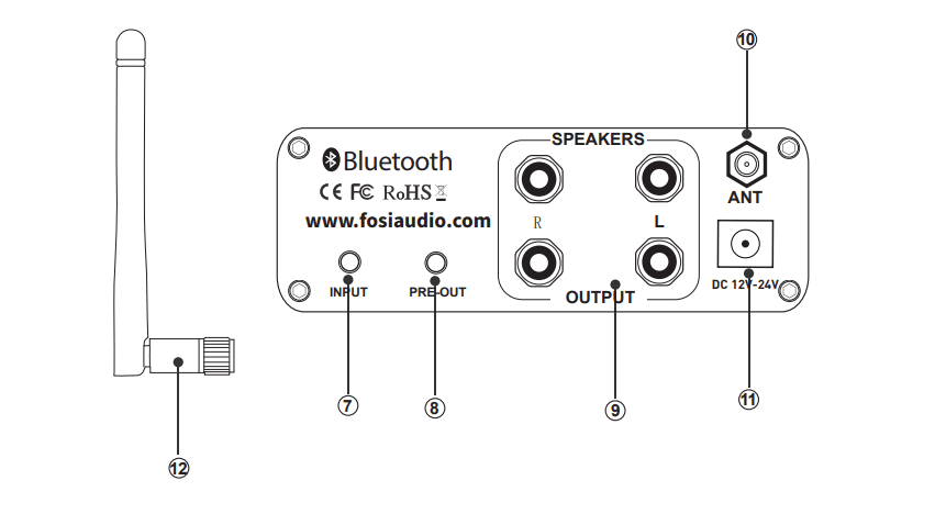

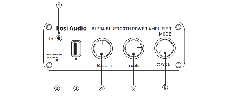

Product Overview​
1: Infrared Radiation
4: Bass Control
2: AUX/U-Disk/Blue tooth Input Indicator  Light
5: Treble Control
3: U-Disk Input
6: Multi-function Knob(Power Switch/  Mode Switch/  Volume Control)
Note: Multi- function Knob: Long press to power on/off; Short press to switch mode; Turn left to decrease the volume; Turn right to increase the volume.
7: 3.5MM AUX Input
8: 3.5MM AUX Pre-output
9: Passive Speakers Output
10: Bluetooth Antenna Interface
11: DC Input
12: Bluetooth Antenna

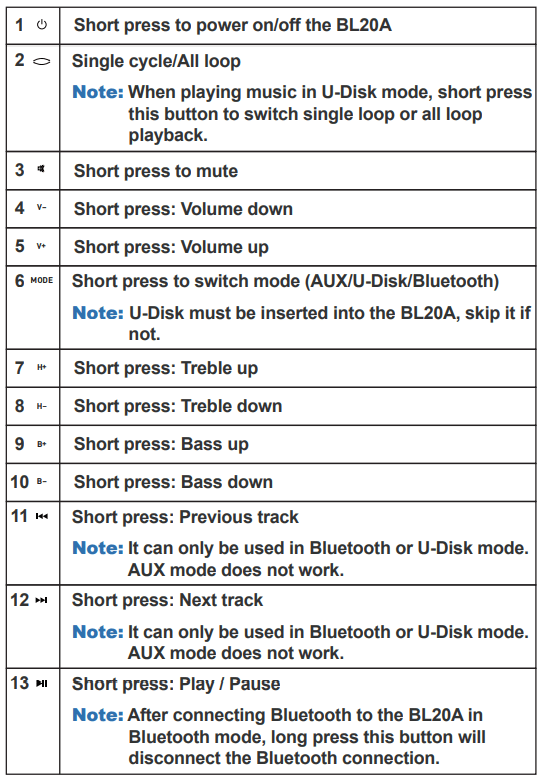

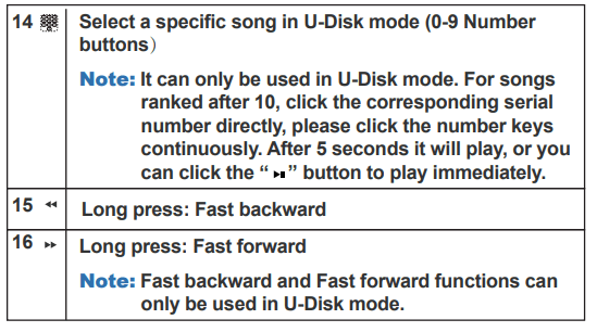

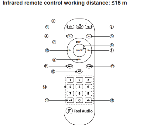

Remote Control​

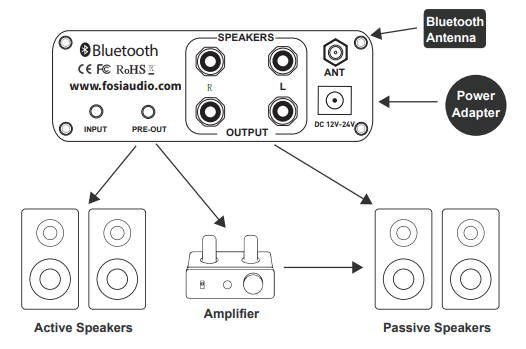

Quick Setup​
Step 1: Install the Bluetooth antenna to the BL20A.
Step 2:
• Use speaker’s wire to connect the speaker’s output to your passive speakers.
• Or use 3.5MM audio cable to connect the 3.5MM AUX pre-out of BL20A to your amplifier, then use speaker’s wire to connect the amplifier with your passive speakers.
• Or use 3.5MM audio cable to connect the 3.5MM AUX pre out of BL20A to your powered speakers.
Note: You don’t need to connect all the outputs. You can connect 2 passive speakers only. Or you can connect it to the pre-out as a preamplifier. And you can connect all the outputs simultaneously.
