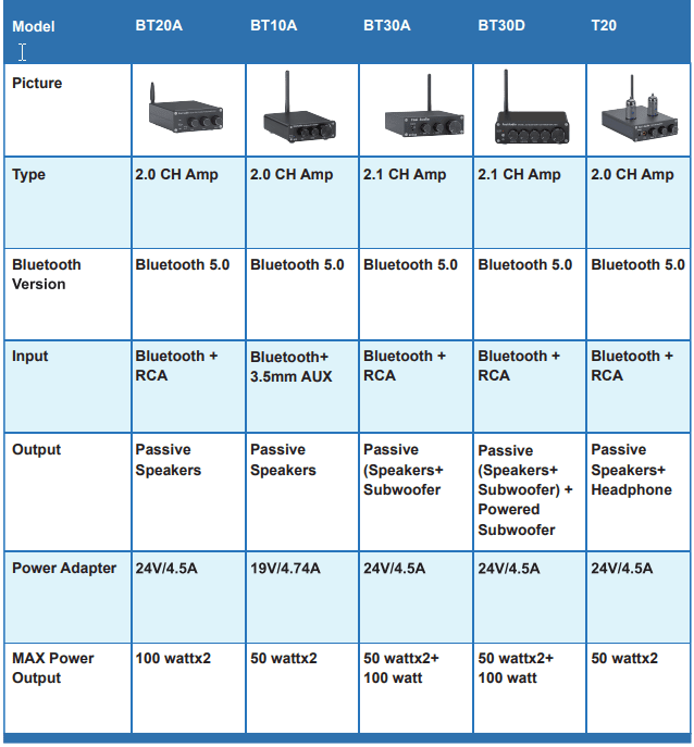

Comparison Section

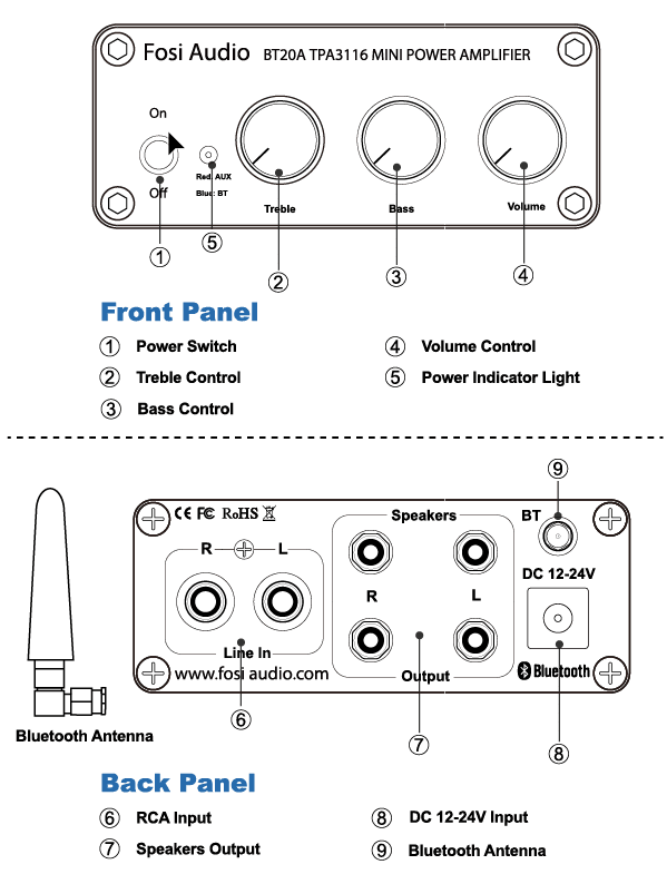

Preparation
Prepare 1: BT20A, 24V power supply, passive speakers, speaker wires or banana plugs;
Prepare 2: Connect the BT20A to the passive speakers via the speaker wire or banana plugs;
Prepare 3: Connect the 24V power supply to the DC input;
Prepare 4: Toggle the power switch on the front panel upwards to turn on the BT20A amplifier.
Note: Be sure that the volume/power switch is in the OFF positionbefore connecting the power supply.

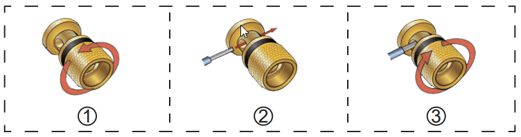

①: Release the horn terminals block terminals;
②: Insert the two ends of the speaker wire into the amplifier and speaker terminal holes;
③: Tighten the horn terminals;

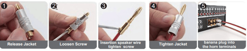

① Release the banana jacket;
② Loosen the screw;
③ Insert the speaker cable and tighten the screw;
④ Tighten the banana plug;
⑤ Insert the banana plug into the horn terminals of the speaker and amplifier.

Step 1: Install the Bluetooth antenna to the BT20A.
Step 2: Turn on the Bluetooth on your phone and search“Fosi Audio BT20A”, after connecting toBT20A, the indicator light shows blue light.
RCA Input for example
Prepare: audio source (take a phone as an example), a RCA cableor a 3.5mm AUX to RCA cable (some devices will need)
Step 1: Connect your phone to BT20A via a 3.5mm to RCA cable;
Step 2: After connecting to BT20A, the indicator light shows red light;
