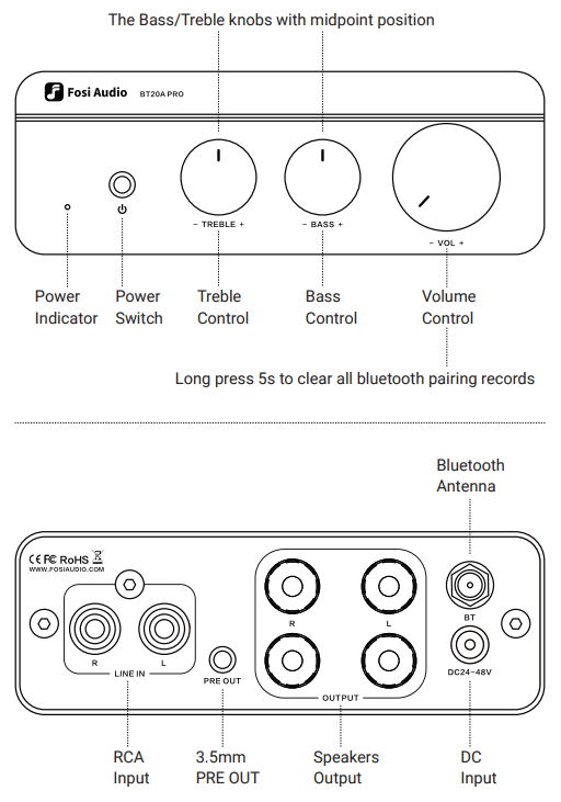

Quick Setup​
Basic operation
Step 1: Install the Bluetooth antenna to the BT20A PRO.
Step 2: Connect your passive speakers to the BT20A PRO via speaker wires.
NOTE: The PRE OUT can be connected to an active subwoofer and speakers. Or you can connect it to the PRE OUT as a preamplifier.
You don’t need to connect all the outputs. You can connect 2 passive speakers only.
And you can connect all the outputs simultaneously.
Step 3: Connect the power supply to BT20A PRO and the socket. Flip the switch's toggle to power on the BT20A PRO. Then the input mode indicator light of BT20A PRO stays red after powered on.
NOTE 1: Please make sure the LED light on the power adapter stays on.
NOTE 2: Before connecting the power supply, please set the bass and treble control to the center position and set the volume to zero to avoid sudden loud noise.
Step 4: Connect the audio source (RCA input/Bluetooth input) to the BT20A PRO.
Step 5: Adjust the Volume control, Bass/Treble control, then enjoy it!
NOTE: Make sure that all the cables are completely pushed into the device.
Connectivity
RCA Input:
Use an RCA cable to connect the BT20A PRO and your device. The input indicator light will stay on Red.
Bluetooth Input:
Turn on the Bluetooth on your device, and select "Fosi Audio BT20A PRO" for pairing, the input mode indicator light will stay blue after a successful connection.
Input priority: The Bluetooth input mode first.
NOTE: Please keep the Fosi Audio BT20A PRO away from other electrical devices. The Fosi Audio BT20A PRO can't use with a radio at the same time.

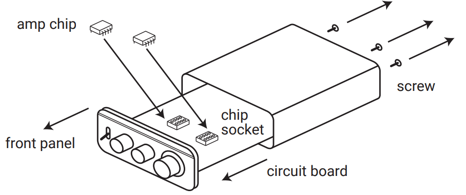

TIP: How to change/replace op-amp?
It is built in with two plug-in NE5532 Op-Amps, different op amps make different sound quality, it can be replaced by LME49720HA/MUSES02/OPA26041P/OPA2134PA/LM4562/NJM4556AD Op-Amps etc.
Use a hex screwdriver to remove the back panel screws, pull the board out and unplug the op-amp, align the holes and reassemble the other op-amps.
Video Tutorial:
https://www.fosiaudio.com/how-to/change-bt20a-pro-op-amp-chip
