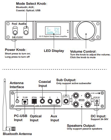

Package Contents
Fosi Audio DA-2120C *1
Remote Control *1
Optical Cable *1
PC-USB Cable *1
Bluetooth Antenna *1
Quick Setup
Preparation
Prepare 1: DA-2120C, 32V power supply, passive speakers, speaker wires or banana plugs;
Prepare 2: Connect the DA-2120C to the passive speakers via the speaker wire or banana plugs;
Prepare 3: Connect the 32V power supply to the DC input;
Prepare 4: Short press the Power Knob to turn on the DA-2120C amplifier.
