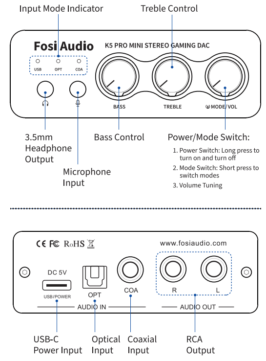

Product Overview &Control Functions

Quick Setup​
USB Input Mode
Prepare: K5 Pro, PC/MAC/PS5/PS4/PS4 Pro/Switch, 2-in-1 USB Type-C cable, 3.5 mm headphone splitter, headphones or powered speakers/sound bar.
Step 1: Connect K5 Pro to your PC/MAC/gaming console via the USB Type-C cable. For PS5, please use the Type-C to Type-C form of the USB cable to connect K5 Pro to your PS5's Type-C port on the front panel. Type-A to Type-C cable could not start up the K5 Pro.
Step 2: Connect your headphones to K5 Pro's headphone and microphone jacks via the 3.5 mm headphone splitter, or connect the powered speakers or sound bar to K5 Pro's RCA output socket or headphone jack;
NOTE: If your headphones don't have microphone or you don't need to speak, just connect your headphones to the 3.5 mm headphone jack without the splitter.
Step 3: Long press the multi-function knob till the Input Mode Indicator lights up blue to turn on K5 Pro;
Step 4: Short press the multi-function knob to select USB input mode, the USB mode light will stay on blue;
Step 5: Left click the sound icon on your PC/MAC and change the sound output device to "Fosi Audio K5 Pro";
Step 6: Play the music on your PC/MAC;
Step 7: Turn up the volume until you hear the sound clearly and then enjoy.
NOTE 1: Please turn down the volume to the minimum before powering on K5 Pro;
NOTE 2: The volume control knob combines the power switch and mode switch. You can long-press to turn on and turn off, short press to switch between modes;
NOTE 3: The K5 Pro can't connect the passive speakers directly. You need to connect it to an amplifier, which Fosi Audio also provides, to drive your passive speakers.
Optical/Coaxial Input Mode
NOTE: In optical and coaxial input modes, the K5 Pro does not support microphone.
Prepare: K5 Pro, 5V AC adapter, USB Type-C cables, 3.5 mm headphone splitter, powered speakers/sound bar, device with optical output or coaxial output (TV for example), optical cable or coaxial cable (not included in the package).
Step 1: Connect the USB Type-C Cable to the AC adapter (or any other DC 5V phone charger or computer USB connector), then connect the USB Type-C cable to K5 Pro;
Step 2: Connect the TV to K5 Pro via optical or coaxial cable;
Step 3: When connecting via optical, set the TV's sound output type to RAW/PCM;
Step 4: Long press the multi-function knob to switch on K5 Pro;
Step 5: Short press the multi-function knob to select OPT or COA input mode;
Step 6: Turn up the volume and enjoy!
NOTE: Some devices' default sound output is Dolby or DTS type, which K5 Pro DOES NOT support. Please remember to select RAW/PCM sound type on your device, otherwise you will hear a lot of noise or no sound output.
