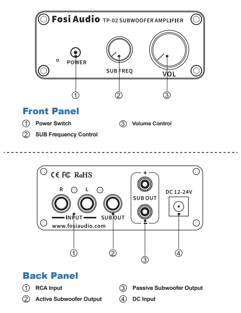

Quick Setup​
Step 1: Prepare TP-02, 24V power supply, passive subwoofer or active subwoofer, speaker wires or banana plugs.
Step 2: Connect the TP-02 to the passive subwoofer, you can connect the passive subwoofer wire via the bare wire or banana plugs.
Step 3: Connect the 24V power supply to the DC Input.
Step 4: Toggle the power switch on the front panel upwards to turn on the TP-02 amplifier.
Note1: Before connecting the power supply, please make sure that the TP-02's power switch is in the “down” position. Otherwise, there will be a “POP” click sound from your subwoofer.
Note2: Before connecting the power supply, please turn down the volume control to 0 (always rotating counterclockwise) to protect your audition from damage.
① Release the horn terminals block terminals.
② Insert the two ends of the speaker wire into the amplifier and speaker terminal holes.
③ Tighten the horn terminals.
Note1: Please make sure that the speaker's wire is not attached the chassis.
Note2: Because the location is relatively small, positive and negative poles can not be in contact
① Release the banana jacket.
② Loosen the screw.
③ Insertion speaker wire and tighten the screw.
④ Tighten the banana jacket.
⑤ Insert the banana plug into the horn terminals of the speaker and amplifier.
Note: Please take care to avoid contact between the two banana plugs so that it will not cause a short circuit because some of the banana plugs are metal-cased.
