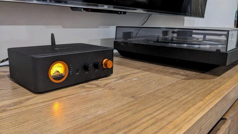

However, when the MC351 was released, I knew I had to buy it. I saw the ad and drooled over it. It was a beauty—a beautifully crafted aluminium chassis with the golden recipe, the TPA3255 chip, and an integrated DAC, meaning I could get rid of an RCA input selector box. On the spec sheet,  the  DAC  looked  pretty  decent.  Minimal cable visibility  has  been a thing since Apple brought their iMac into this world, and I knew this little box was going to add that slick character to my lounge. Yes, my lounge. I was ready to say goodbye to my old faithful DIY class AB amp.   I  have three  inputs: Google Chromecast Audio, a Sony  LX310 turntable, and a TV. Nothing special. Chromecast Audio can handle a few not-so-fancy streaming services well enough (e.g., Spotify, YouTube Music, etc.) and can support Qobuz up to a 96kHz sampling rate. My three inputs beautifully connected to the MC351: Chromecast via optical, turntable via RCA, and TV via  Bluetooth. If your turntable has no integrated phono stage, you will have to add a phono preamp to connect to the MC351.
One thing I noticed was the nice implementation of input selection. It remembers the last input it used. If you switch it off and switch it back on, it will stay at the same input. It is a nice touch. I have seen many cheap audio products revert to the default option when turned on.
Bluetooth was also implemented very well. After my TV successfully paired with the MC351, I switched to Bluetooth, and the TV sound came out of the audio system as expected. If I switch
the input to something else, for example, optical, the amp quickly unpairs from the TV, letting the TV sounds come out of the TV speakers. (If it was poorly implemented, it could have held up the Bluetooth connection, inadvertently muting the TV sound.) It saved me from having to fiddle with the remote control and navigate TV menus to unpair the amp, which was great. When I switch back  to  Bluetooth,  the  amp  immediately  pairs  with  the  TV  again  and  plays  the  TV  sound seamlessly. I have seen many products fail to do this simple thing!

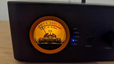

The VU metre is a nice touch. It is mesmerising to watch the movement of the needle. However, the volume has to be reasonably high to see most of it. Imagine yourself sitting alone at night, a glass of whiskey in hand, and your favourite jazz track playing. But you don’t want to wake up the family, so you set the volume low. Sadly, the VU metre is not working as hard when you kinda want it the most.

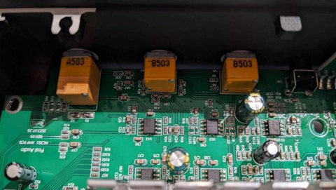

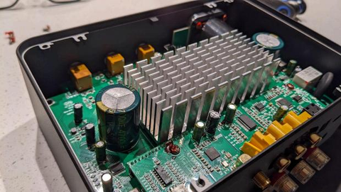

I opened up the case to examine the quality of components and upgradability. Most components are surface mount, except for the electrolytic capacitors. One thing I instantly noticed was the beefy 4700uF reservoir capacitors. The inductors appear to be from Sumida. Unlike Fosi’s other recent products (e.g., V3, ZA3), I wasn’t able to see premium brand components like Nichicon and WIMA capacitors.
I wanted to see if it allowed opamp upgrades, but it didn’t look promising. I spotted 8 NE5532 op amps, directly soldered onto the surface of the board.

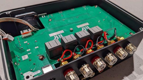

A separate board appears to be the DAC and Bluetooth. I was unable to see what lies under this board as I failed to undo the screw.
