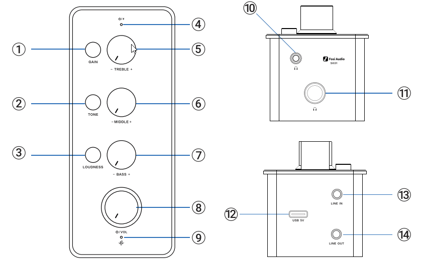

Product Overview
① GAIN: Initially set to high gain mode, press to switch to low gain mode
② TONE: Press to disable the treble, midrange, and bass adjustment
③ LOUDNESS:Enhances both treble and bass when listening at low volume
④ Power indicator: Red light stays on during charging, turns off when fully charged. Green light stays on during operation with sufficient voltage. Green light flashes when battery is low
⑤ TREBLE: Adjusts the high-frequency range at 10kHz (±8dB)
⑥ MIDDLE: Adjusts the mid-frequency range at 1kHz (±10dB)
⑦ BASS: Adjusts the low-frequency range at 50Hz (±11dB)
⑧ Power/Volume knob
⑨ Signal Indicator: Light flashes in red and blue alternately when the output voltage reaches 2V, indicating the excessive volume
⑩ 3.5mm headphone jack
⑪ 6.35mm headphone jack
⑫ DC 5V USB-C power input
⑬ 3.5mm LINE IN
⑭ 3.5mm LINE OUT
