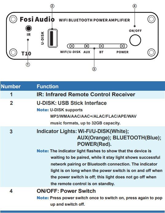

Quick Setup​
Preparation
Prepare 1: T10, power supply, passive speakers or active subwoofer or other amplifiers or the headphone, speaker wires or banana plugs;
Prepare 2: Connect the T10 to the passive speakers via the speaker wire or banana plugs, or connect the T10 to the active subwoofer or other amplifiers or the headphone via 3.5mm AUX output;
Prepare 3: Connect the power supply to the DC input;
Prepare 4: Short press the Power Switch to turn on the T10 amplifier.
Note: Be sure that the Power Switch is in the OFF position before connecting the power supply.
Note: Please turn down the sound of your phone and T10 before playing to avoid the volume being too loud when you turn on your device.

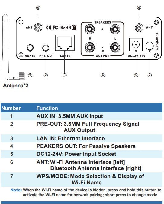

8. Why can't I find a Wi-Fi name on my phone that starts with "Fosi Audio T10"?
  • This is usually caused by the Wi-Fi name being hidden, you just need to press and hold the "WPS/MODE" button for 3 seconds and the Wi-Fi name starting with "Fosi Audio T10" will be
