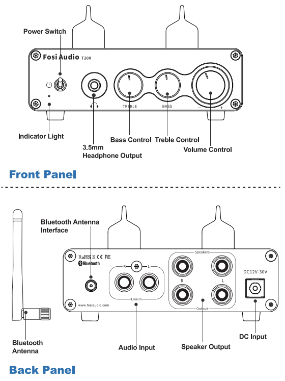

Prepare 1: T20X, 24V power supply, passive speakers, speaker wires or banana plugs;
Prepare 2: Insert the tube carefully and make sure that all pins are fully inserted.
Prepare 3: • Connect the T20X to the passive speakers via the speaker wires, you can connect the speaker's wire via the bare wire or the banana plugs;
                  • Or Connect a wired headset to the Headphone Output on the front panel of the T20X.
Prepare 4: Connect the 24V power supply to the DC input;
Prepare 5: Turn on the Power Switch.
Note: Before turning on the power switch of the amplifier, please turn the volume button to the lowest position.
Note: Be sure that the power switch is on the OFF position before connect the power supply. Please turn on the T20X first and then turn on the speakers to avoid noise.
Method 1 : Bare wire connection illustration
 ① : Release the horn terminals block terminals;
 ② : Insert the two ends of the speaker wire into the amplifier and speaker terminal holes;
 ③ Tighten the horn terminals;
Note: Please make sure that the speakers’ wire are not attached with each other, the speaker connection area is very narrow, it is easy to cause the positive and negative speakers’ wires to contact each other, which will result in no sound output.
Method 2 : Banana plugs connection illustration
① Release the banana jacket;
② Loosen the screw;
③ Insertion speaker wire and tighten the screw;
④ Tighten the banana jacket;
⑤ Insert the banana plug into the horn terminals of the speaker and amplifier.

Step 1: Install the Bluetooth antenna.
Step 2: Turn on the Bluetooth on your phone and search “Fosi Audio T20X", the indicator stays blue after a successful pairing.
AUX Input
Prepare: audio source (take TV as an example), a RCA cable or a 3.5mm AUX to RCA cable.
Step 1: Connect your TV to “Audio Input" via a RCA cable;
Step 2: Open your TV, play and enjoy
