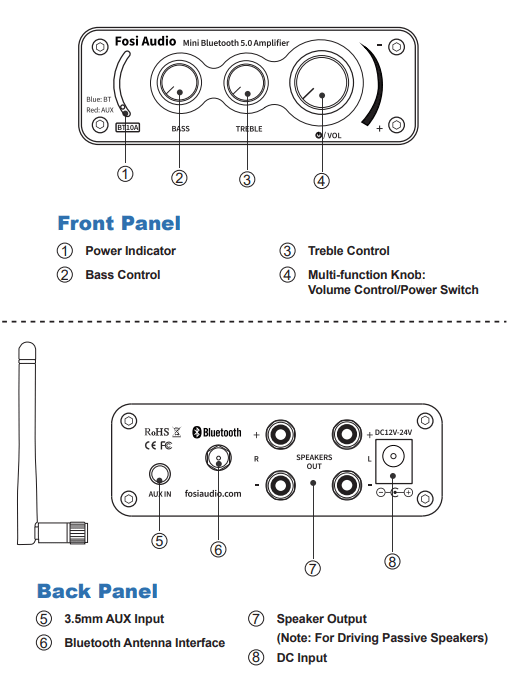

Quick Setupโ€‹
Preparation
Prepare 1: BT10A, 19V power supply, passive speakers, speaker wires or banana plugs;
Prepare 2: Connect the BT10A to the passive speakers via the speaker wire or banana plugs;
Prepare 3: Connect the 19V power supply to the DC input;
Prepare 4: Twist the power knob in a clockwise direction, turn on the BT10A amplifier.
Note: Be sure that the volume/power switch is in the OFF position before connecting the power supply.
โ‘  Release the horn terminals block terminals;
โ‘ก Insert the two ends of the speaker wire into the amplifier and speaker terminal holes;
โ‘ข Tighten the horn terminals;
Note: Please make sure that the speakersโ€™ wire are not attached with each other, the speaker connection area is very narrow, it is easy to cause the positive and negative speakersโ€™ wires to contact each other, which will result in no sound output
โ‘  Release the banana jacket;
โ‘ก Loosen the screw;
โ‘ข Insert the speaker cable and tighten the screw;
โ‘ฃ Tighten the banana plug;
โ‘ค Insert the banana plug into the horn terminals of the speaker and amplifier.
Bluetooth for example
Prepare your Bluetooth device (take a phone as an example)
Step 1: Install the Bluetooth antenna to the BT10A.
Step 2: Turn on the Bluetooth on your phone and search. โ€œ Fosi Audioโ€or โ€œFosi Audio BT10Aโ€, after connecting to BT10A, the indicator light shows blue light.
3.5mm AUX for example
Prepare: audio source (take a phone as an example), a 3.5mm AUX cable or a 3.5mm AUX to RCA cable (some devices will need).
Step 1: Connect your phone to BT10Aโ€™s AUX interface via a 3.5mm AUX cable;
Step 2: After connecting to BT10A, the indicator light shows red light;

10: How to distinguish Power Switch and Volume Control?
โ€ข Power switch means turn the power switch knob clockwise for one time to power on the BT10A. Adjusting the volume means turning the volume control knob clockwise to adjust the volume.
