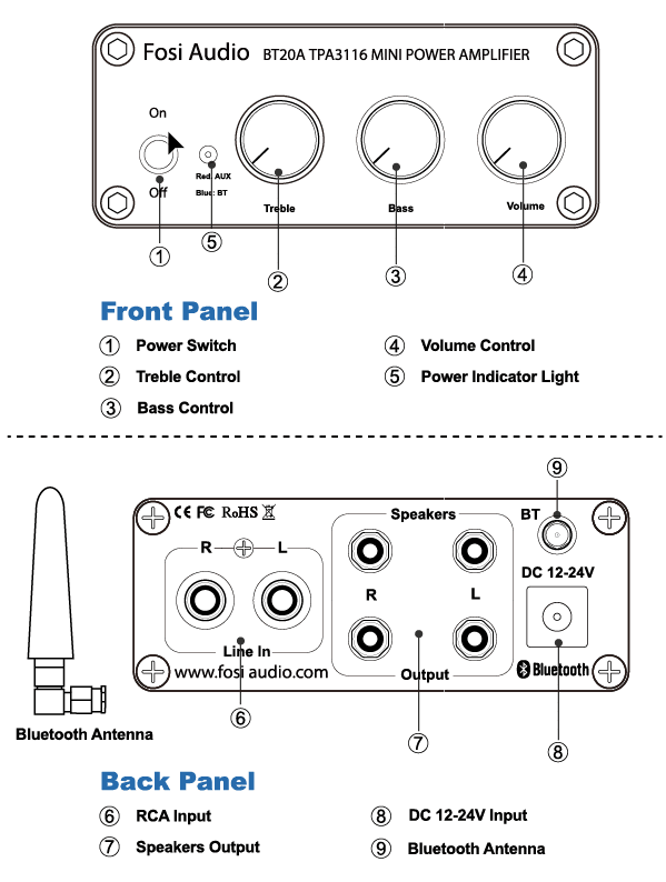

Quick Setupโ€‹
Preparation
Prepare 1: BT20A, 24V power supply, passive speakers, speaker wires or banana plugs;
Prepare 2: Connect the BT20A to the passive speakers via the speaker wire or banana plugs;
Prepare 3: Connect the 24V power supply to the DC input;
Prepare 4: Toggle the power switch on the front panel upwards to turn on the BT20A amplifier.
Note: Be sure that the volume/power switch is in the OFF positionbefore connecting the power supply.

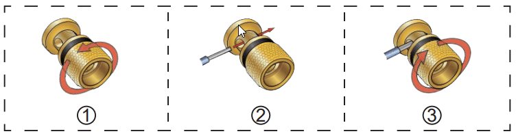

โ‘ : Release the horn terminals block terminals;
โ‘ก: Insert the two ends of the speaker wire into the amplifier and speaker terminal holes;
โ‘ข: Tighten the horn terminals;
Note: Please avoid the speaker wires being exposed and touchingthe amplifier casing, as this may cause a short circuit fault;

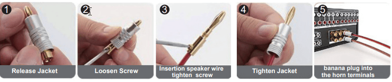

โ‘  Release the banana jacket;
โ‘ก Loosen the screw;
โ‘ข Insert the speaker cable and tighten the screw;
โ‘ฃ Tighten the banana plug;
โ‘ค Insert the banana plug into the horn terminals of the speaker and amplifier.

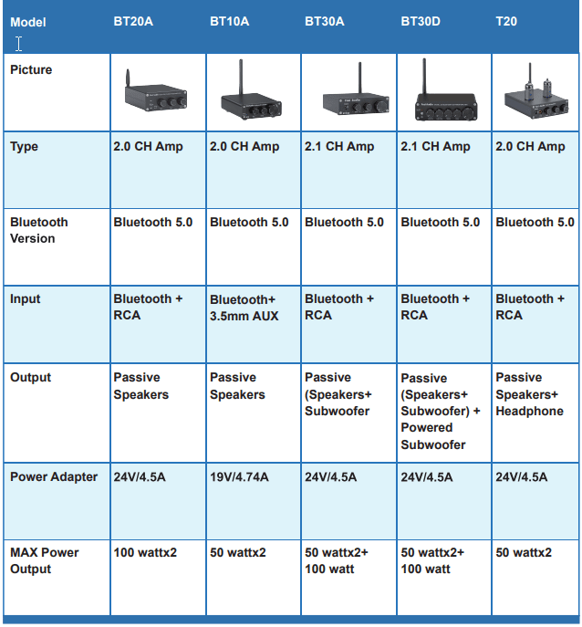

18: What is the difference between BT20A and BT10A?
โ€ข Fosi Audio BT20A has 100 Watts*2 MAX power output, the Fosi Audio BT10A has 50 Watts*2 MAX power output.
