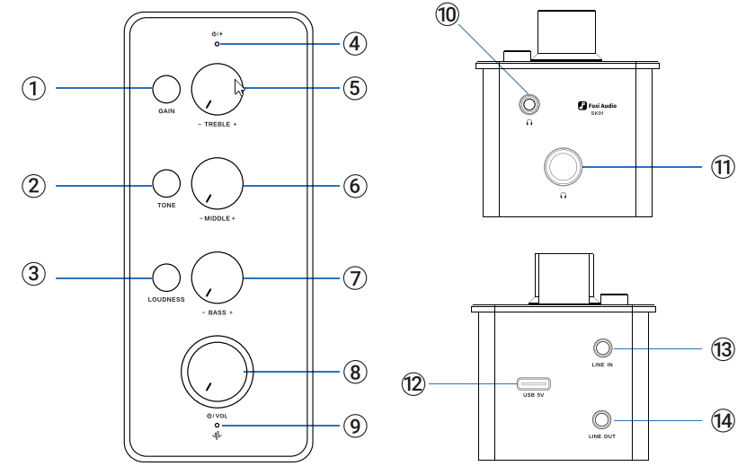

Product Overview
โ‘  GAIN: Initially set to high gain mode, press to switch to low gain mode
โ‘ก TONE: Press to disable the treble, midrange, and bass adjustment
โ‘ข LOUDNESS๏ผšEnhances both treble and bass when listening at low volume
โ‘ฃ Power indicator: Red light stays on during charging, turns off when fully charged. Green light stays on during operation with sufficient voltage. Green light flashes when battery is low
โ‘ค TREBLE: Adjusts the high-frequency range at 10kHz (ยฑ8dB)
โ‘ฅ MIDDLE: Adjusts the mid-frequency range at 1kHz (ยฑ10dB)
โ‘ฆ BASS: Adjusts the low-frequency range at 50Hz (ยฑ11dB)
โ‘ง Power/Volume knob
โ‘จ Signal Indicator: Light flashes in red and blue alternately when the output voltage reaches 2V, indicating the excessive volume
โ‘ฉ 3.5mm headphone jack
โ‘ช 6.35mm headphone jack
โ‘ซ DC 5V USB-C power input
โ‘ฌ 3.5mm LINE IN
โ‘ญ 3.5mm LINE OUT
