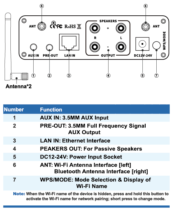

1: Can I use T10 to create a 2.1 Channel system?
• Yes, you can connect two passive speakers via "Speakers Out" and one active subwoofer via "PRE-OUT" to create a 2.1 Channel system.
• Please use a 3.5mm audio cable to connect your active Subwoofer to the "PRE-OUT" output port.

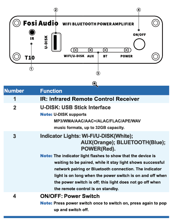

8.My Bluetooth device can’t pair with T10?
• Make sure that T10 is on Bluetooth mode and the blue indicator is flashing, while it stay light shows successful Bluetooth connection.
• Make sure that T10 is not paired with other devices.
• Make sure that the distance between your device and T10 is not too long, close your device to T10 to have a try.
• Make sure there are no obstacles between your device and T10, obstacles will affect the Bluetooth operation distance.
• Please plug your power supply one again and restart the T10 and then try to connect again, try to use another brand of mobile phone.
9.Why can't I find a Wi-Fi name on my phone that starts with "Fosi Audio T10"?
• This is usually caused by the Wi-Fi name being hidden, you just need to press and hold the "WPS/MODE" button for 3 seconds and the Wi-Fi name starting with "Fosi Audio T10" will be shown.
