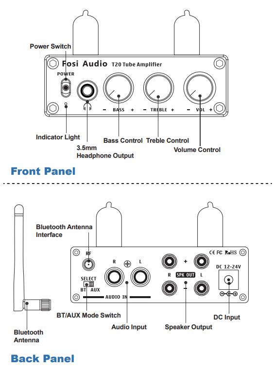

Quick Setup​
Preparation
Prepare 1: T20, 24V power supply, passive speakers, speaker wires or banana plugs;
Prepare 2: Insert the tube carefully and make sure that all pins are fully inserted.
Prepare 3: β€’ Connect the T20 to the passive speakers via the speaker wires, you can connect the speaker's wire via the bare wire or the banana plugs;
β€’ Or Connect a wired headset to the Headphone Output on the front panel of the T20, the speaker output will disconnect once the headset is plugged in.
Prepare 4: Connect the 24V power supply to the DC input;
Prepare 5: Turn on the Power Switch.
Note: Before turning on the power switch of the amplifier, please turn the volume button to the lowest position.
Note: Be sure that the power switch is on the OFF position before connect the power supply. Please turn on the T20 first and then turn on the speakers to avoid noise.
β‘ : Release the horn terminals block terminals;
β‘‘: Insert the two ends of the speaker wire into the amplifier and speaker terminal holes;
β‘’: Tighten the horn terminals;
Note: Please avoid the speaker wires being exposed and touchingthe amplifier casing, as this may cause a short circuit fault;
β‘  Release the banana jacket;
β‘‘ Loosen the screw;
β‘’ Insert the speaker cable and tighten the screw;
β‘£ Tighten the banana plug;
β‘€ Insert the banana plug into the horn terminals of the speaker and amplifier.
Bluetooth Input
Prepare your Bluetooth device (take a phone as an example)
Step 1: Install the Bluetooth antenna.
Step 2: Select the input mode switch to BT on the back panel of the T20, The indicator is blue and flashing.
Step 3: Turn on the Bluetooth on your phone and search β€œ Fosi Audio” or β€œFosi Audio T20”, the indicator stays blue after a successful pairing.
Step 4: Open the audio application, play and enjoy!
AUX Input
Prepare: audio source (take a TV as an example), a RCA cable or a 3.5mm AUX to RCA cable.
Step 1: Select the input mode switch to AUX on the back panel of the T20, the indicator light shows red light;
Step 2: Connect your TV to β€œAudio Input” via a RCA cable;
Step 3: Open your TV, play and enjoy!
