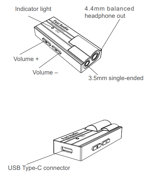

Product Overview

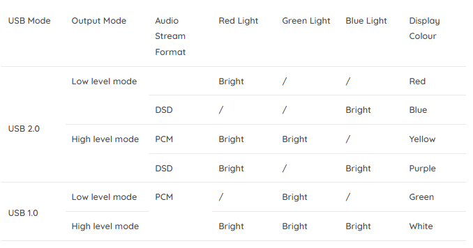

High and Low Level Mode Switching
Indicator Light
