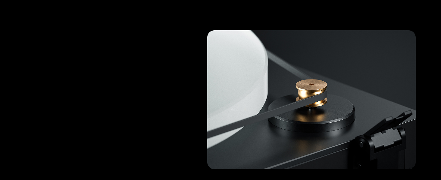

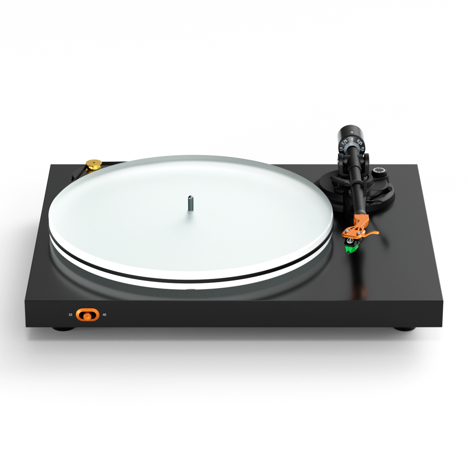

The Luna3 features a high-mass acrylic platter to reduce vibration for smoother playback. A precision tonearm ensures accurate tracking, while the removable headshell allows easy upgrades. Its copper motor with servo control maintains stable speed for natural, detailed sound.
  • Speed: 33, 45 (electronic speed change)
  • Speed Variation: 33: 0.13% 45: 0.13%
  • Wow & Flutter: 33: 0.15% 45: 0.15%
  • Platter: 300mm (acrylic)
  • SNR: 65dB
Smart Features That Just Make Sense
Smart Practicality

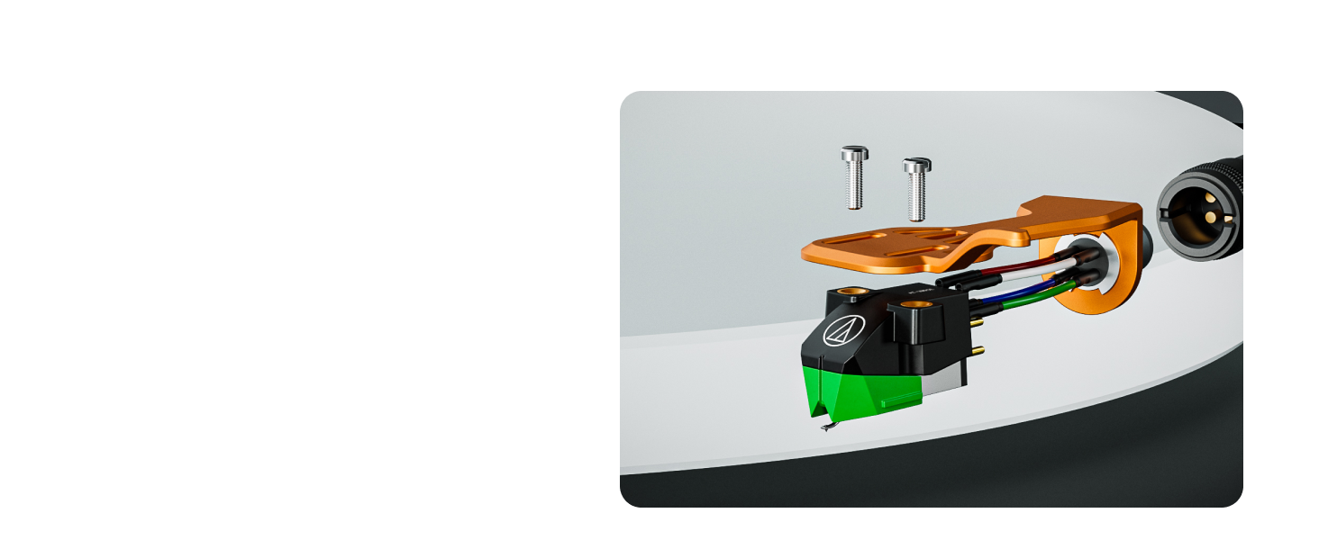

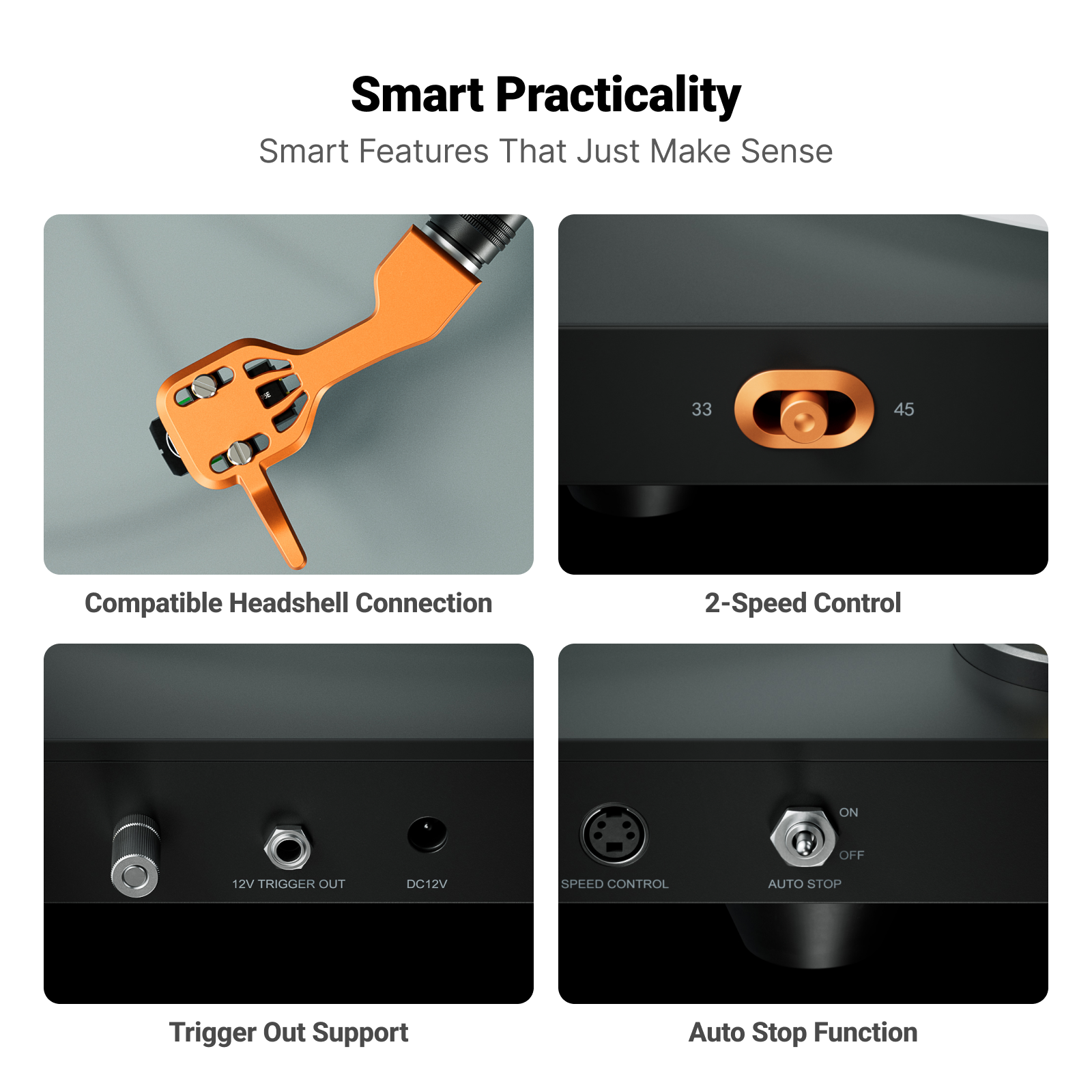

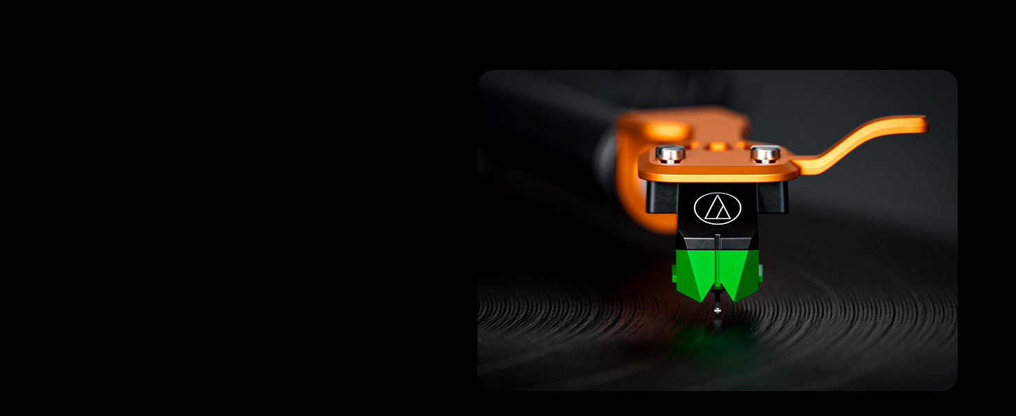

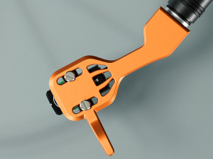

Compatible Headshell
A standard connector allows you to easily swap the entire headshell

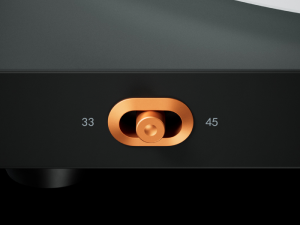

2-Speed Control
33/45 RPM, play all your vinyls

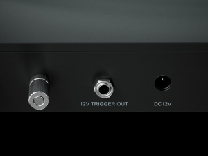

Trigger Out Support
Synchronize power-on/off with your downstream devices

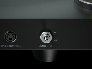

Auto Stop Function
Stops when the record ends, easy and safe

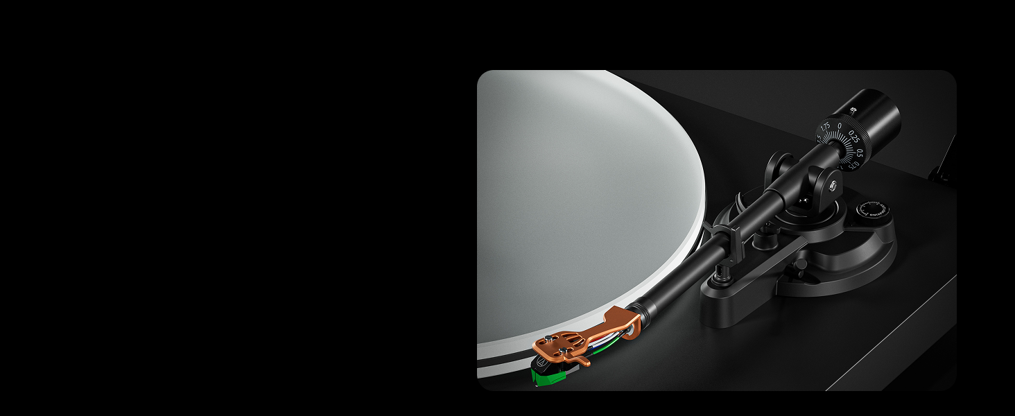

Tonearm Length & Material: 8.6in (aluminum)
Tonearm Diameter: 12.2mm
Effective Arm Length: 218.5mm
Overhang: 22mm

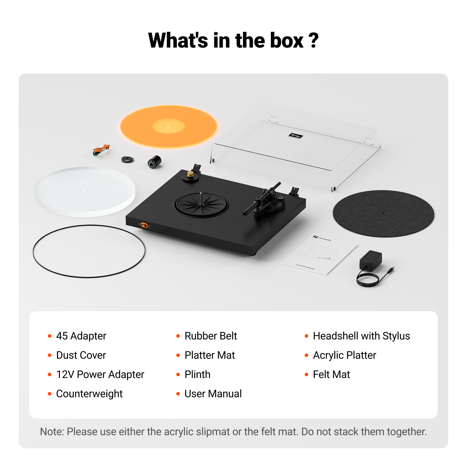

  • 45 Adapter ×1
  • Dust Cover ×1
  • 12V Power Adapter ×1
  • Counterweight ×1
  • Rubber Belt ×1
  • Platter Mat ×1
  • Plinth ×1
  • User Manual ×1
  • Headshell with Stylus ×1
  • Acrylic Platter ×1
  • Felt Mat ×1

​Under the hood, Fosi made the right calls where it counts. Driven by an ultra-steady servo motor and Hall sensor system, it maintains precise speed stability. Out of the box, it comes equipped with a reliable Audio-Technica AT-VM95E moving-magnet cartridge, delivering natural, well-controlled low-end response and crisp, articulate vocals without artificial coloring. Because Fosi deliberately omitted a built-in phono preamp, you get a direct, uncompromised analog signal path that gives you total freedom to pair it with a proper downstream phono stage and amplifier of your choice.
​Additionally, user-friendly touches like the removable universal headshell and easy cartridge upgrade path mean this deck won't become a bottleneck as your system evolves.

There is a speed switch on the front that doubles as a power switch. 33 RPM to the left, 45 RPM to the right. Rest the speed switch in the middle and it turns off the turntable. There is also an auto-stop switch on the back of the turntable, as well as a 12v trigger. I can’t say I’ve ever used the 12v trigger before, but it is there if that is something you like. RCA out and a ground round out the back panel (along with a speed control out).

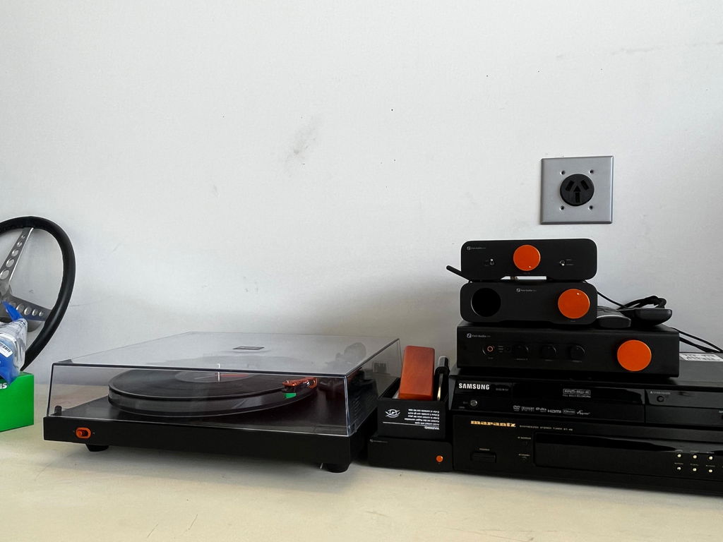

I have connected the Luna 3 to my Fosi Áudio Stack but I’m still testing the best way avoid interference of a DOUK Audio EQ5 in the signal path. It seems it’s not a good ideia to have the EQ5 at all, so I’ll probably try taking it out of the way to test the sound quality which right now is not at higher levels.
Looks and performance! What a value!!!
Not sure where to start, I’ve had it for a few weeks now and at first I was thinking it was a bit expensive, not knowing what these things cost.
After getting it, I was happy to see the packing and unboxing experience (so many companies get this wrong). Fist impressions were positive, and even though there is a bit too much plastic for my taste, I figured it was ok.
Was surprised to see it came with RCA cables, even though I actually got some from Fosi when I purchased it so I guess I have a spare set now.
Connecting was easy, I’ve never calibrated a turn table so I was worried, but figured it out, and soon enough I was paying records.
Such a wonderful experience and I do think the audio technica cartridge is great to start, but already thinking of going with the upgrade options (red or brown).
