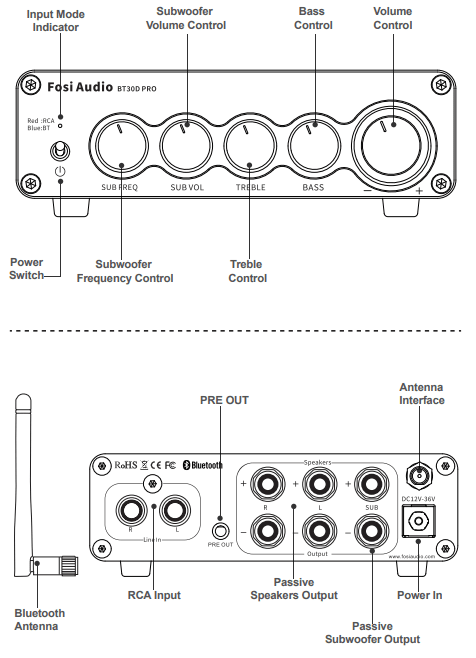

Quick Setupโ€‹
How to Use?
Step 1:
โ‘  Connect the power adapter to the socket and the BT30D PRO. Please make sure the green LED light on the power adapter stays on.
โ‘ก Connect the active (powered) speakers to the BT30D PRO.
โ‘ข Connect passive speakers to the BT30D PRO using banana plugs or bare wire. Then turn on the power switch.
Step 2:
โ‘  RCA line input: Use an RCA cable to connect the BT30D PRO and your device. The input mode indicator light will turn red after a successful connection.
โ‘ก Bluetooth input: Turn on the Bluetooth on your device, then select "Fosi Audio BT30D PRO" for pairing, the input mode indicator light will turn blue after a successful connection. Once Bluetooth is connected, the RCA input will be interrupted. If you want to use the RCA input again, just disconnect the Bluetooth.
Step 3:
โ‘  Adjust the volume control, SUB volume/ Frequency control, Bass / Treble control, then enjoy it!
Note: Make sure that all the cables are completely pushed into the device.
