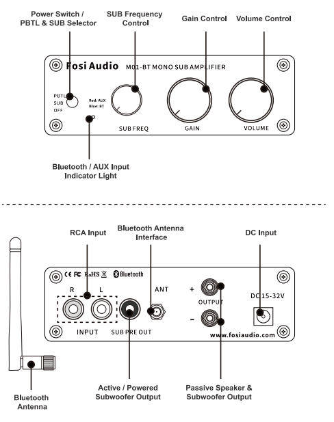

Quick Setupโ€‹
How to Use?
Step 1:
โ‘ lnstall the Bluetooth antenna. Connect the power adapter to the socket and the M01-BT. Please make sure the blue LED light on the power adapter stays on. Then flip up the power switch button on the front panel. The input indicator light is on.
โ‘กSwitch to PBTL (As a full frequency mono amp): You can use the banana plugs or bare wires to connect the passive speaker to the M01-BT. Use the RCA cable to connect the powered subwoofer to the M01-BT.
โ‘ขSwitch to SUB (As a subwoofer amp): You can use the banana plugs or bare wires to connect the passive subwoofer to the M01-BT. Use the RCA cable to connect the powered subwoofer to the M01-BT.
Step 2:
โ‘ RCA Input: Use the RCA cable to connect the M01-BT with your device. The input mode indicator light on the front panel will stay on Red after a successful connection.
โ‘กBluetooth Input: Turn on the Bluetooth on your device, then select "M01-BT" for pairing, the input mode indicator light will stay on Blue after a successful connection. Once Bluetooth is connected, the RCA input will be interrupted. If you want to use the RCA input again, just disconnect the Bluetooth.
Step 3:
Adjust the Volume control, SUB Frequency control, Gain control, then enjoy it!
Note: Make sure that all the cables are completely pushed into the device.
