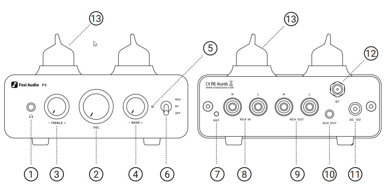

โ‘  3.5mm headphone jack
โ‘ก Volume knob
โ‘ขTreble knob (ยฑ6dB)
โ‘ฃBass knob (ยฑ12dB)
โ‘คMode indicator light: RCA mode - steady red light, Bluetooth pairing mode - blue light flashing, Bluetooth connection successful - steady blue light
โ‘ฅPower switch/mode selector
โ‘ฆBluetooth reset switch: Hold for 3 seconds to clear Bluetooth pairing
โ‘งRCA input
โ‘จRCA output
โ‘ฉAUX output
โ‘ชDC 12V power in
โ‘ซBluetooth antenna port
โ‘ฌ5654W tubes

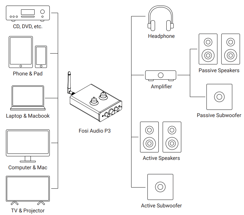

3. Depending on your setup, plug your amplifier, powered speakers, or headphones into the P3's RCA output, AUX output, or headphone jack;
4. If you opt for a wired connection, use an audio cable to connect your source device to the P3's RCA input terminal;
5. Switch to either the RCA wired or BT Bluetooth wireless position;
