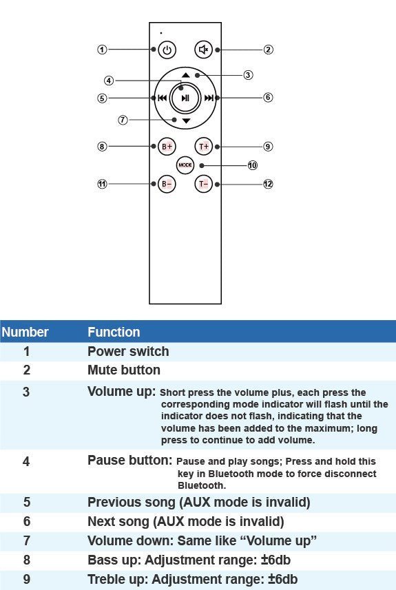

Infrared Remote Control​

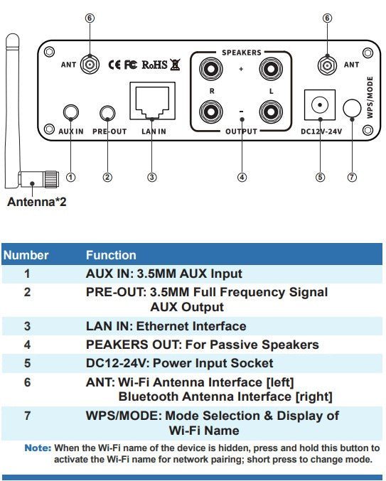

Prepare 1: T10, power supply, passive speakers or active subwoofer or other amplifiers or the headphone, speaker wires or banana plugs;
Prepare 2: Connect the T10 to the passive speakers via the speaker wire or banana plugs, or connect the T10 to the active subwoofer or other amplifiers or the headphone via 3.5mm AUX output;
Prepare 3: Connect the power supply to the DC input;

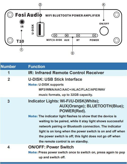

Prepare 4: Short press the Power Switch to turn on the T10 amplifier.
Note: Be sure that the Power Switch is in the OFF position before connecting the power supply.
Note: Please turn down the sound of your phone and T10 before playing to avoid the volume being too loud when you turn on your device.
β‘  Release the horn terminals block terminals;
β‘‘ Insert the two ends of the speaker wire into the amplifier and speaker terminal holes;
β‘’ Tighten the horn terminals.
Note: Please avoid the speaker wires being exposed and touching the amplifier casing, as this may cause a short circuit fault.
β‘  Release the banana jacket;
β‘‘ Loosen the screw;
β‘’ Insertion speaker wire and tighten the screw;
β‘£ Tighten the banana jacket;
β‘€ Insert the banana plug into the horn terminals of the speaker and amplifier.

U-DISK Mode:
Insert the USB flash drive into the U-DISK port of the T10, the T10 will automatically recognize the songs in the USB flash drive and play music. The white indicator will stay light after successful connected.

Troubleshooting/QA​
1: Can I use T10 to create a 2.1 Channel system?
  • Yes, you can connect two passive speakers via "Speakers Out" and one active subwoofer via "PRE-OUT" to create a 2.1 Channel
  • Please use a 3.5mm audio cable to connect your active Subwoofer to the "PRE-OUT" output

5.  Can I use wired headphone with T10?
  • Yes, you can connect your headphone with T10 via β€œPRE-OUT”.

  1. My Bluetooth device can't pair with T10?
  • Make sure that T10 is on Bluetooth mode and the blue indicator is flashing, while it stay light shows successful Bluetooth

8. Why can't I find a Wi-Fi name on my phone that starts with "Fosi Audio T10"?
  • This is usually caused by the Wi-Fi name being hidden, you just need to press and hold the "WPS/MODE" button for 3 seconds and the Wi-Fi name starting with "Fosi Audio T10" will be
