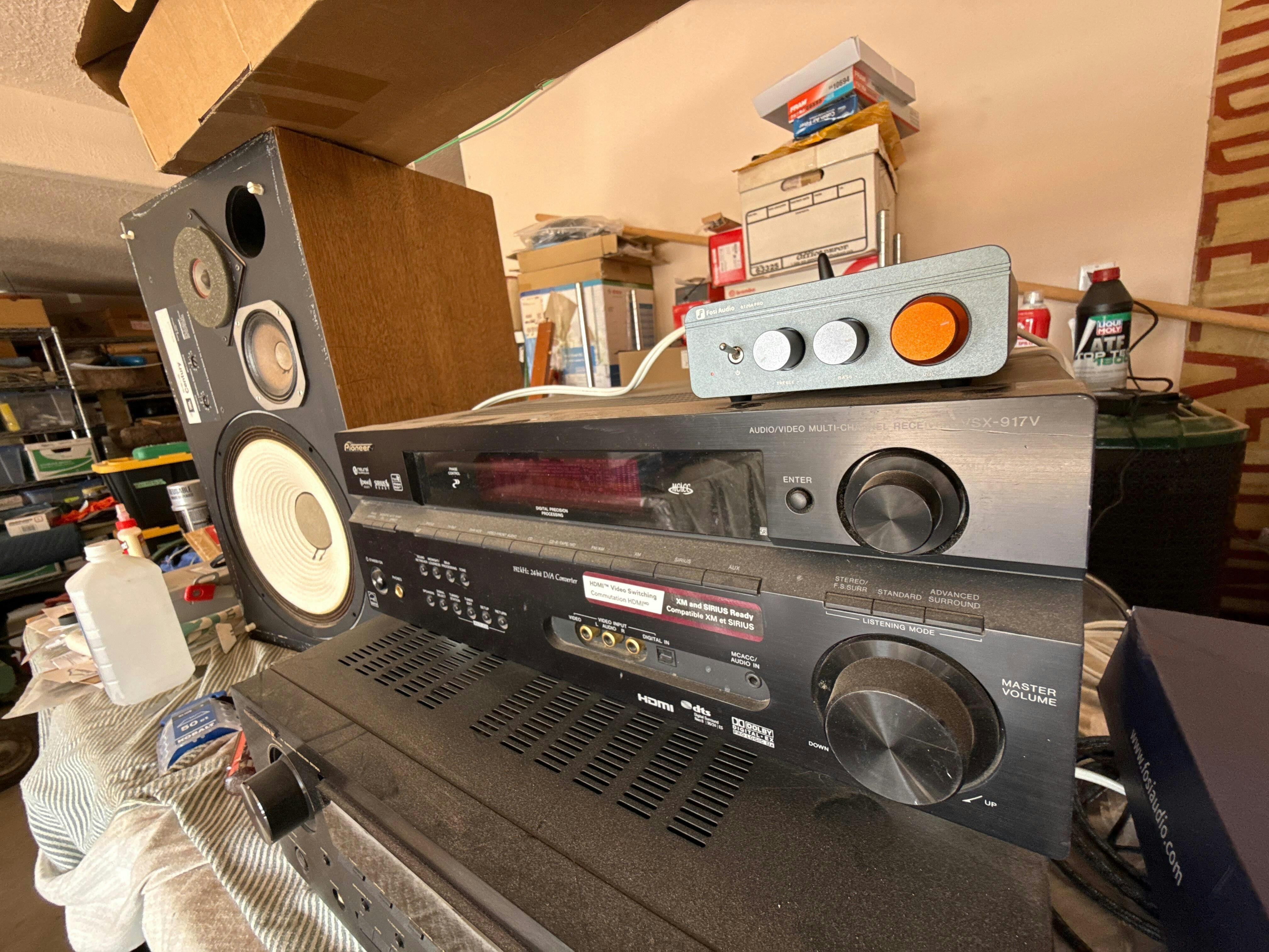

- Bass & Treble Control with Midpoint Positioning
- Op-Amp Rolling: SS3602, MUSES02, OPA2604AP, OPA2134PA
- Replaceable Knobs: ORANGE KNOB, GREY KNOB

- Sound Control: With its unique design, the BT20A Pro amplifier for home audio has a wide range of bass and treble controls. Alternatively, you can turn the treble and bass effects to a middle point to listen to the original sound without effects.
