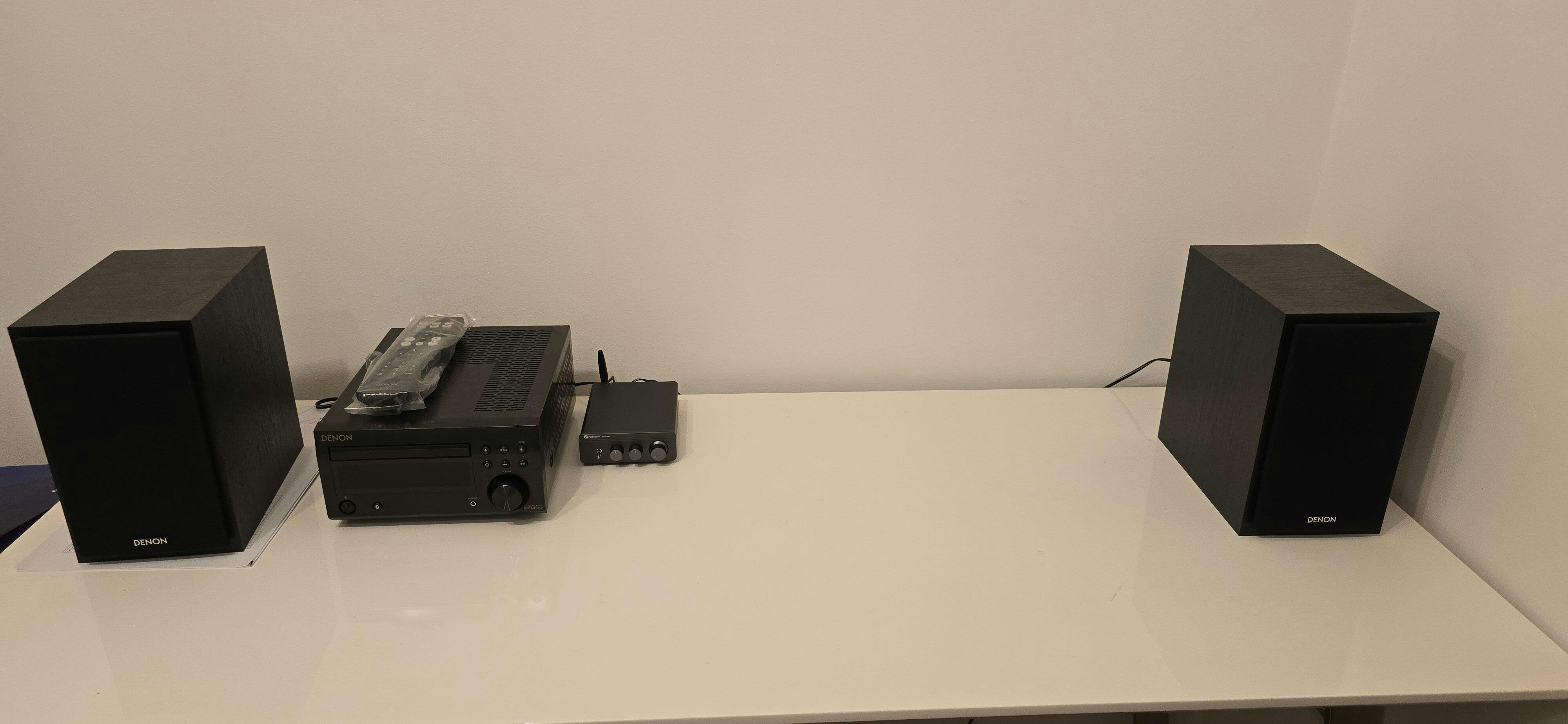

I bought Fosi BT20A PRO as a step into small class D amps world (and I wasnt worried about class D vs class AB war over SQ for the reason I used class D amps in car audio like Hertz HDP4 and HDP1 and bennefits of class D are for me more grater then eventual loss in terms of SQ).
I chose it because its an amp and bluetooth reciver (after reading detail review on ASR forum and of course comments ) and it has volume dependant sub or aux out which is important to me because I will connect Polk Audio HTS 10 active sub to it to help little Denon SCM41 bookshelf speakers.For now I am happy because the sound is good, amp is powerfull, bluetooth connection is good and quality is ok, knobs are solid and nice to turn, and after reading that amp becomes warm even when not in use but powerd on I was little affraid of overheating, but when amp arrived I didnt experience such thing, i paired it with 48V 5A Fosi GAN power adapter. Amp doesnt get hot after few hours of listinening over BT on moderate volume and power adapter stays cool. Now next problem for me is to buy solid floorstanders to pair with the Fosi BT20A PRO and use it in the living room, and after that we will see and maybe try V3 monos with ZD3, but first I will enjoy in Fosi BT20A Pro and my little Denon speakers, especialy in combo with POLK HTS10 to help with low frequencies.
