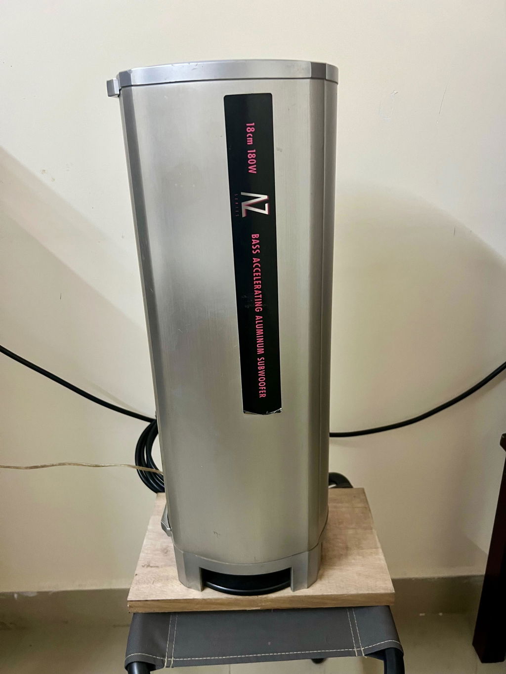

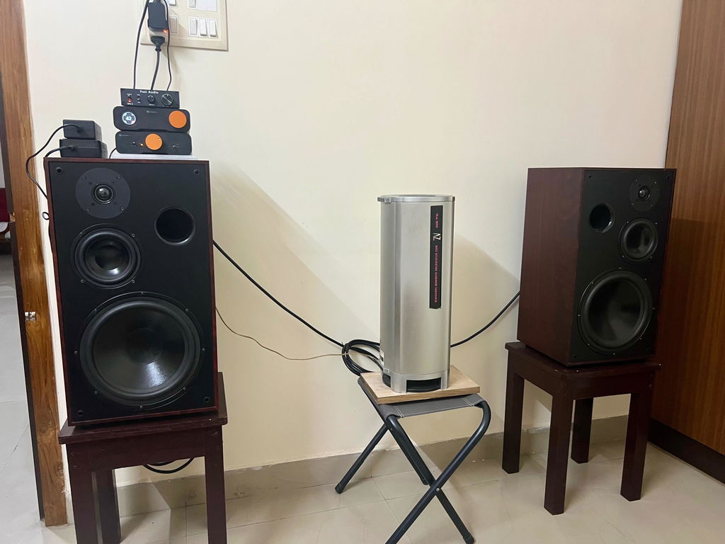

      PERFECT SUBWOOFER APM FOR MY 180W PASSIVE SUBWOOFER
      This subwoofer amp has brougth life to my 2005 vintage Sony make 180watt passive subwoofer . I am using M0-3 Amp as Subwoofer amp. Connected from subwoofer output of ZA-3 AMP . This setup is working absolutely fine. I am happy with this setup.

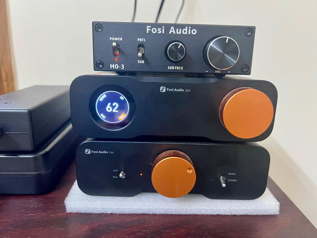

      I hooked the M)3 amp to the ZP3 preamp to drive my spare Rockford Fosgate P3SDH10 subwoofer which I took out from my old car. I was able to adjust the crossover and the bass blends well with my Sonus Faber Sonetto G1 Speakers. Happy with the improved bass extension

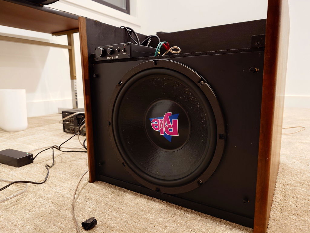

      I have an older Infinity 12" powered sub that it's internal amplifier stopped working. This little Fosi amp I am now using to replace the broken one. Sound and output of the sub is a great pairing for this sub and reasonable cost compared to a new plate amp. I was suprised how well it controlls the 12" sub with no distortion at typical listening levels.
