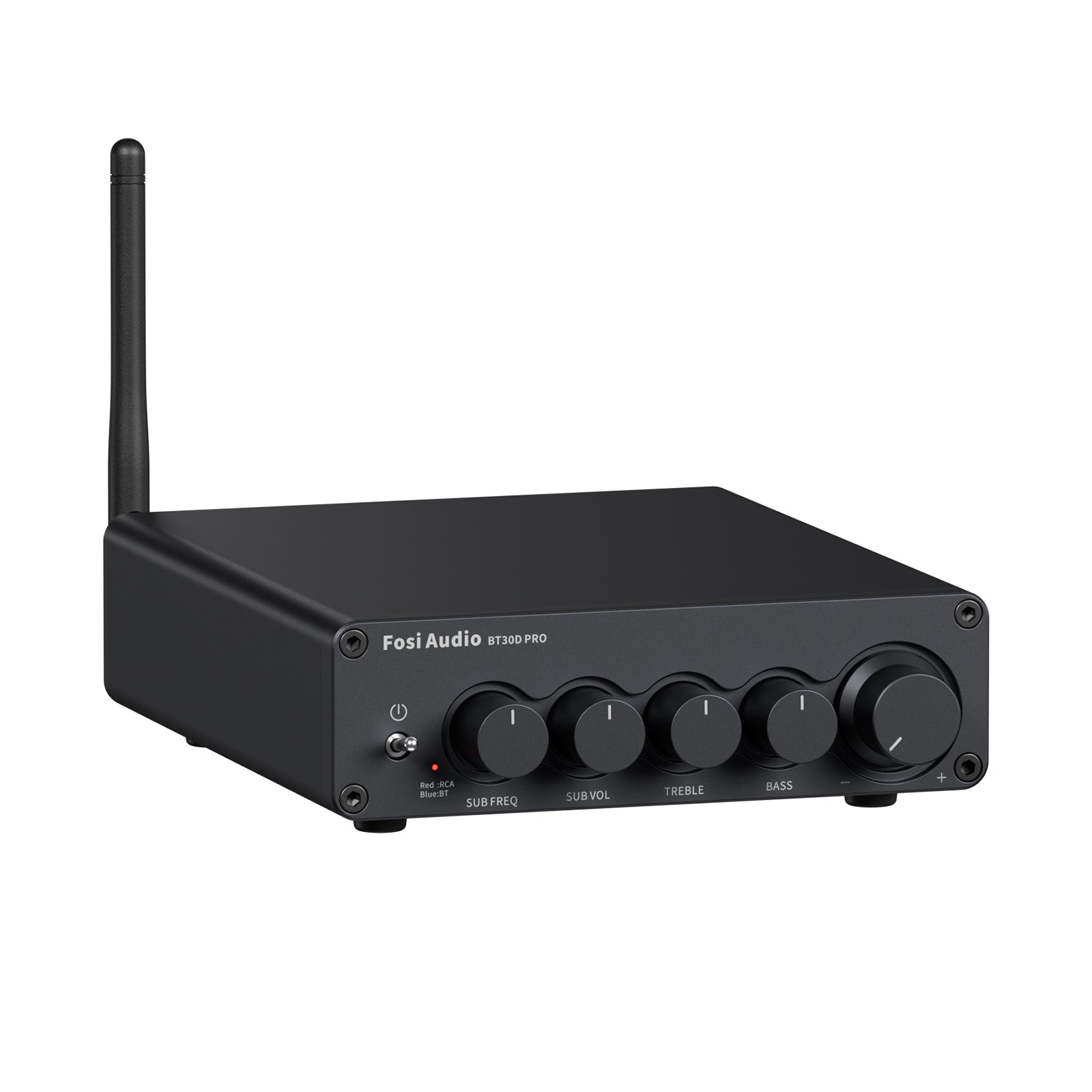

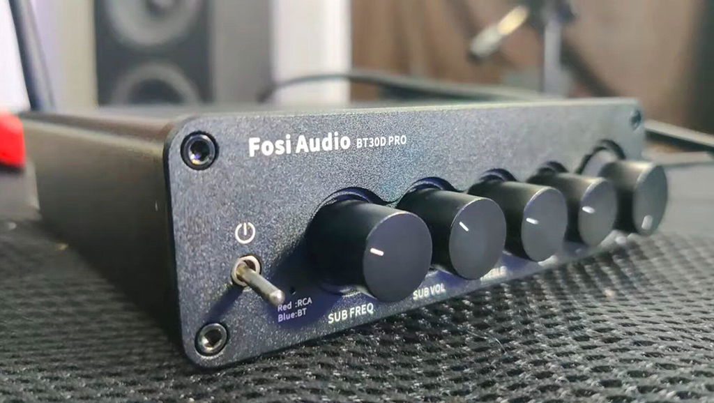

Knobs designed for subwoofer

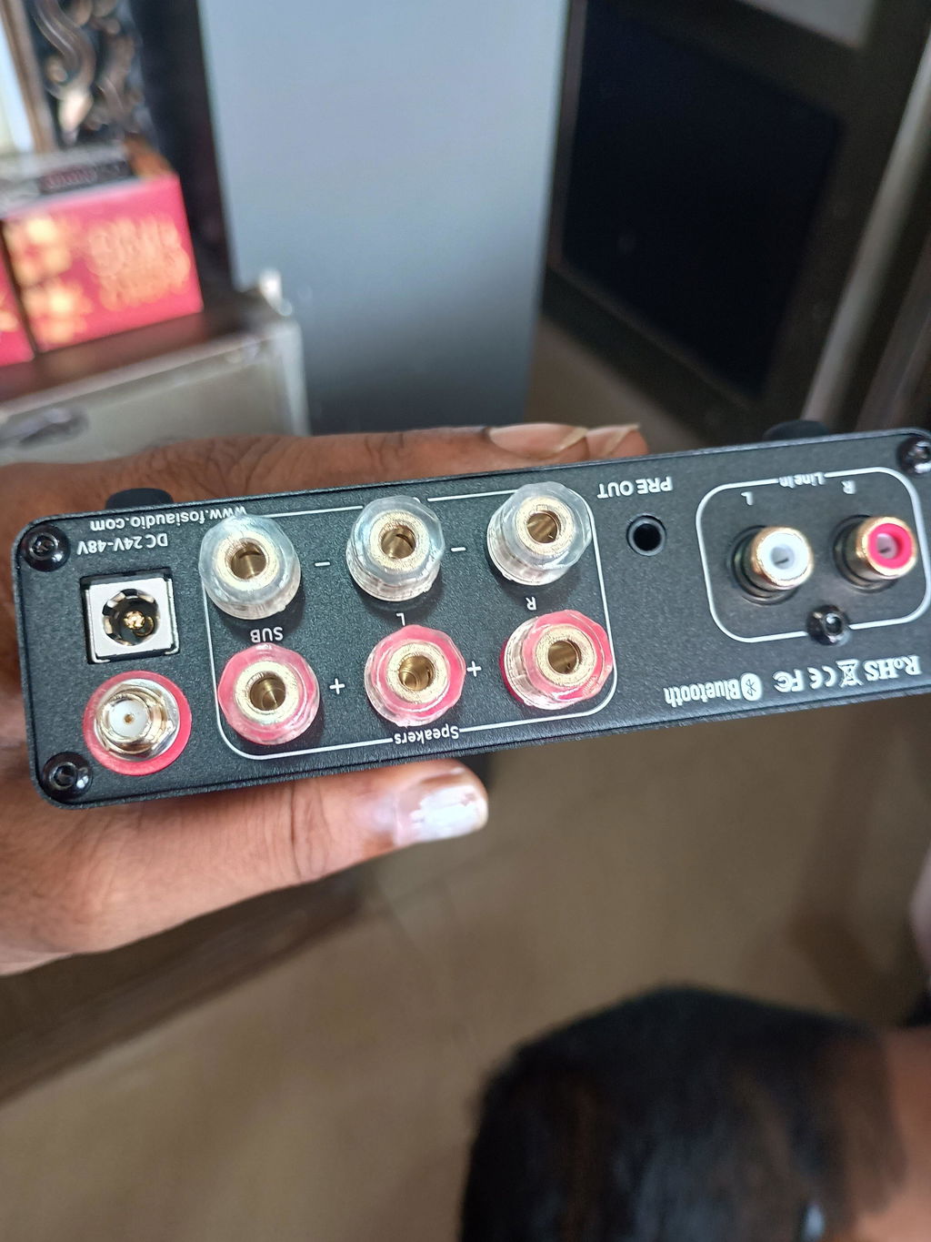

The SUB FREQ knob allows frequency adjustment of passive subwoofers from 0 to 300 Hz, and the SUB VOL knob sets their volume.

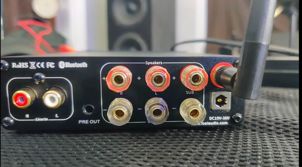

Pre-Out Connector
Build a home stereo system on your desktop by connecting a powered speaker, subwoofer, or amplifier to the BT30D Pro through the 3.5mm PRE output for a compact audio receiver setup.
  • 2.1 Channel Amplifier: The BT30D PRO integrated amplifier features two sets of passive speaker outputs and one set of passive subwoofer outputs, making it easy to set up a 2.1 home theater or other stereo HiFi audio systems.
  • Bass Beast: Whether you're a gamer, movie buff, or music lover, the subwoofer amplifier provides tight, smooth, and natural - sounding bass. It features two dedicated knobs for subwoofer control: the SUB FREQ knob allows precise frequency adjustment of passive subwoofers from 0 to 300 Hz, while the SUB VOL knob lets you set the desired volume level. This gives you full control over the bass output to suit your personal preferences and listening environment.
  • Bluetooth 5.0 Connectivity: It maintains a stable connection and delivers clear audio over a range of up to 15 meters. This makes it perfect for enjoying your favorite tunes or audio content in outdoor areas such as your yard, terrace, or poolside, without worrying about signal drop-outs or interruptions.
  • Exquisite Craftsmanship: This mini amplifier is meticulously crafted with a solid, all - metal body that ensures durability and longevity. The well-designed case, along with the high-quality controls and connectors, exudes a sense of premium build and attention to detail. The exquisite packaging further adds to the overall appeal and value of the bass amp.

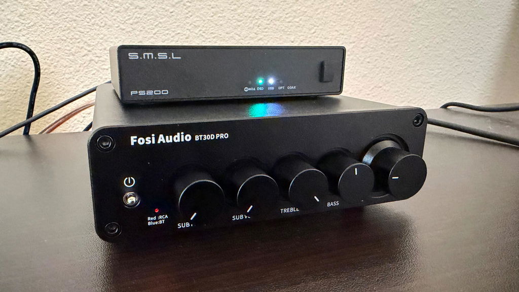

Philippe (Canada)
The foundation of a Hi-Fi setup
I was recently inspired to assemble a Hi-Fi setup when my father offered me a vintage turntable. So after a couple of months of searching and info gathering I opted for this expertly crafted mini amplifier.
When I unboxed it, my first impression was that it looked smaller than I imagined. Nonetheless, the BT30D Pro performed beyond my expectations, when I streamed music on a pair of Fluance bookshelf speakers via Bluetooth, i was impressed by the clarity and detail of the mids and highs. Bass and treble knobs are easy to use. Bass is good and I intend to add a subwoofer to the BT30D pro.
I ordered the 48v 5a power supply and the mini amp feels warm to the touch but never hot, I wanted to be sure I had enough headroom for my speakers that have a relatively low sensitivity rating of 85db. I kept the volume knob below 40% and it was loud enough for my taste.
So this is the starting point of my Hi-Fi setup, a compact yet very capable mini amp.

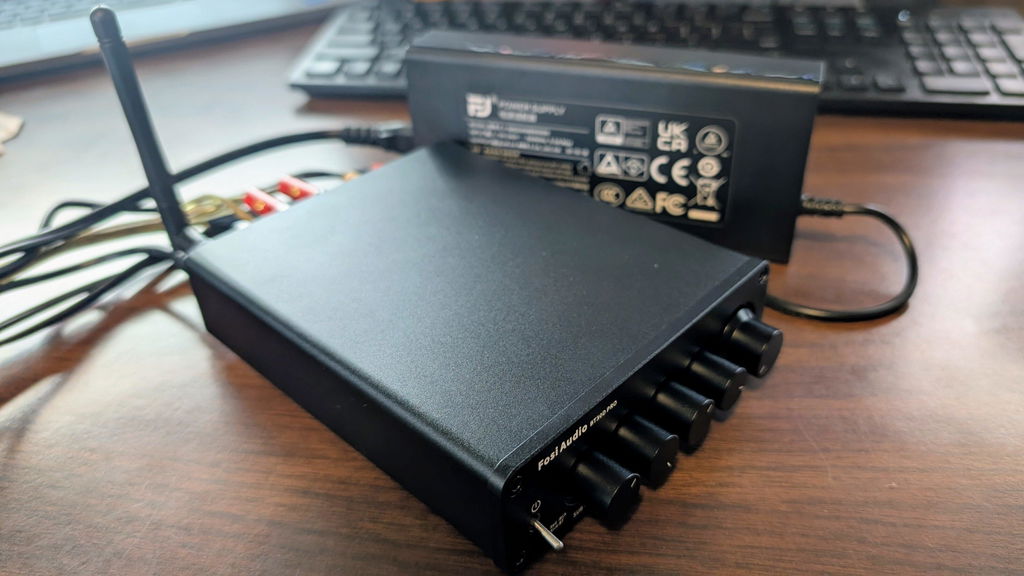

smit2680 (United States)
Haveing fun seeing what it can push 😁
Love the little unit but does get warm quick ( with 48 v 10 amp brick) . 4 ohms make it wourse of course - 16 ohms not as bad but not as loud lol. Adding a small fan next .All so got a v3 stereo to add to it soon .

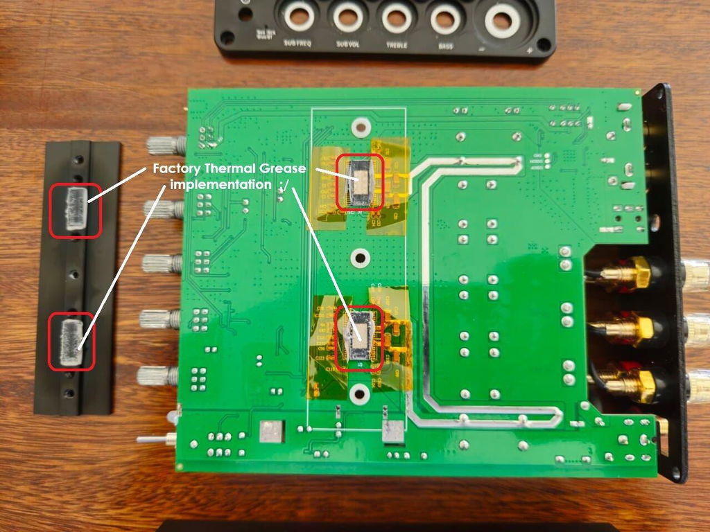

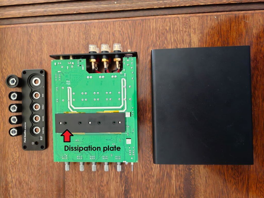

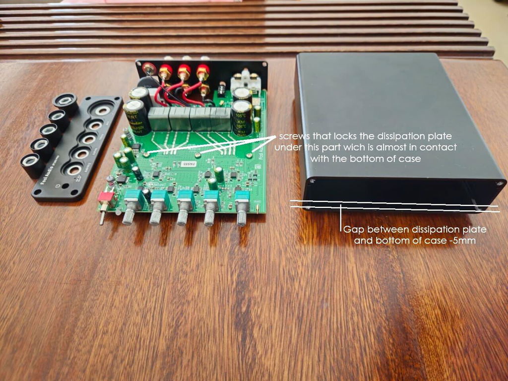

Excellent sound, Worst heat protection implementation
First of all, I would like to emphasize that I am very satisfied with this unit in terms of sound quality, output power, material construction, size, price, and overall performance. In these aspects, I truly have no complaints.
That said, the implementation of ventilation and heat dissipation by Fosi Audio is highly problematic. The device has no effective ventilation system, as it is essentially a sealed enclosure. Consequently, the heat generated by the internal components—particularly the amplifiers—cannot be adequately dissipated through the aluminum plate, which is the sole element intended for thermal regulation. Moreover, this plate is positioned in the narrowest section of the chassis, further limiting its effectiveness.
As a result, after only 15 to 20 minutes of playback at volumes of 60% or higher, the unit consistently triggers protective power shutdowns. This makes continuous use beyond that timeframe impractical.
A redesign is urgently needed to enable proper passive ventilation without requiring owners to resort to custom modifications to correct such a fundamental flaw.

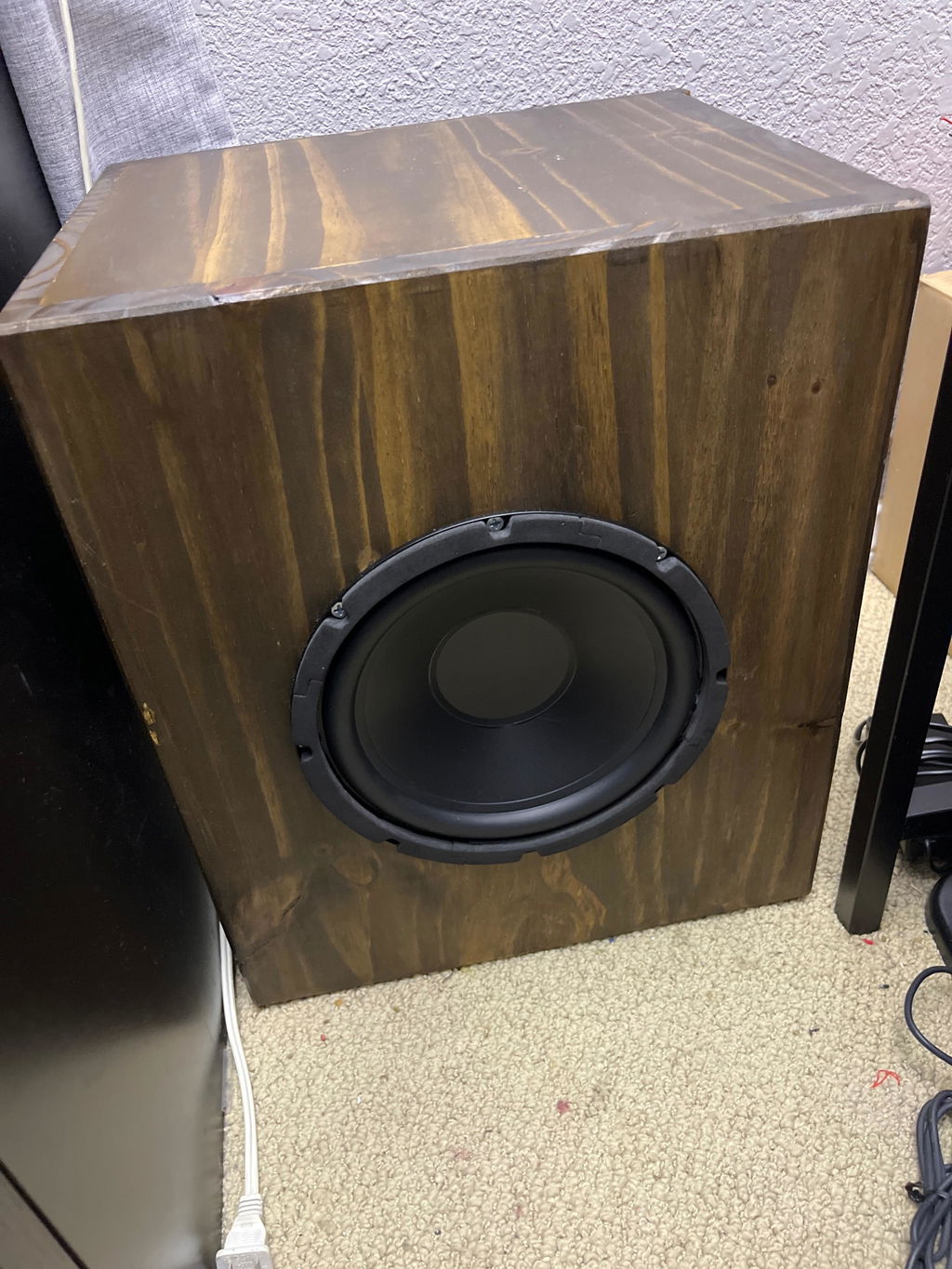

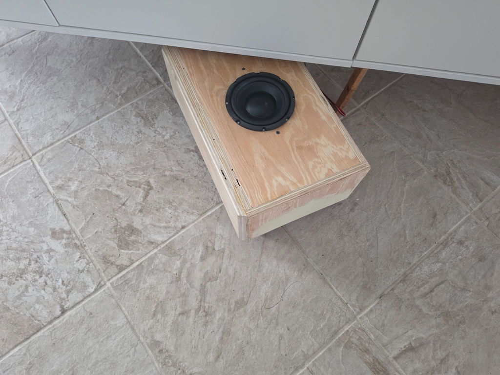

Wow I love this amp already! I built my own 8” subwoofer and this powers it perfectly. It looks super clean in my setup and doesn’t take up very much space. I will definitely be purchasing more products from Fosi in the future!

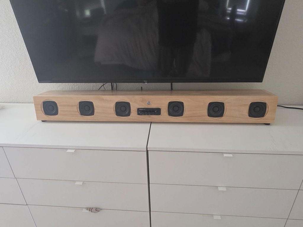

Replace a 3216 chip amp with this amazing amp. What a difference. Powers 6 drivers plus 1 sub. Thanks fosi audio.

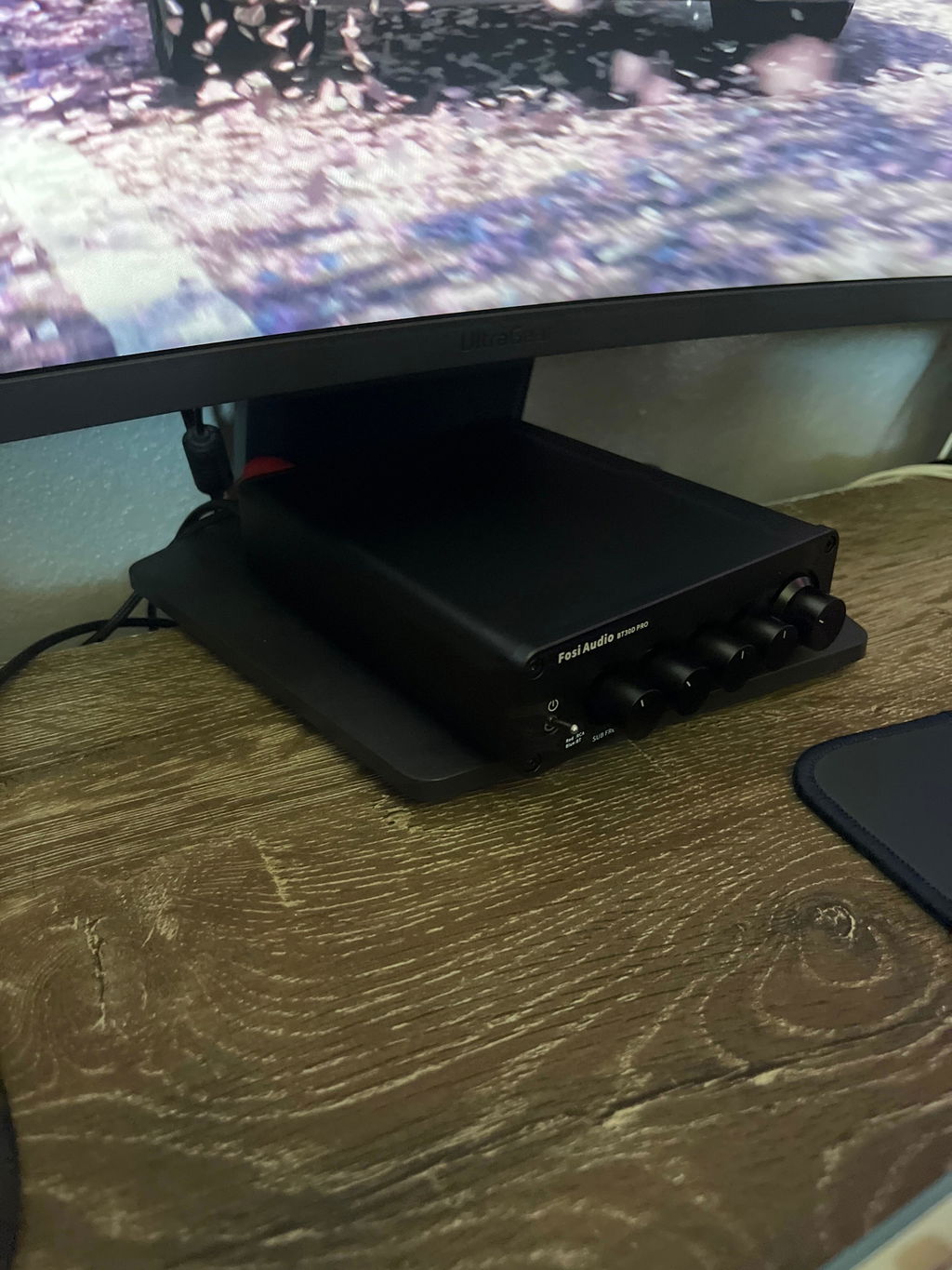

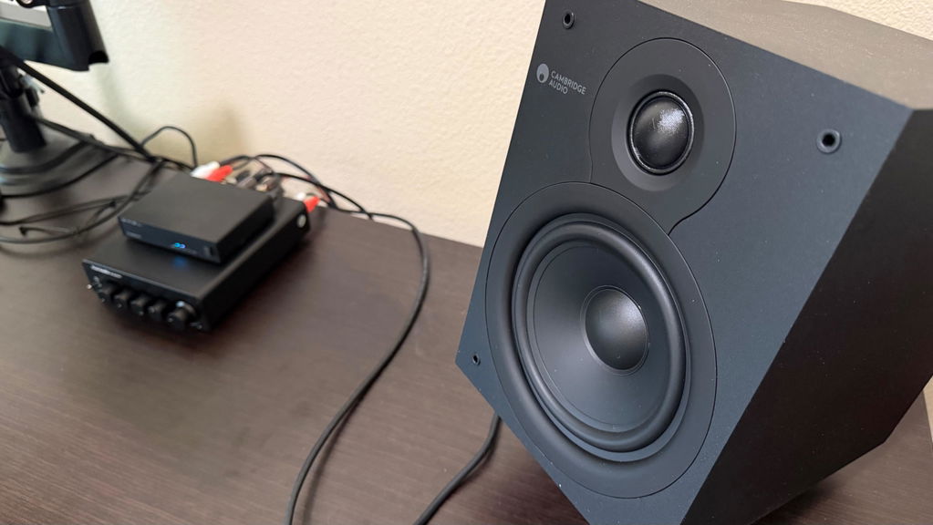

I use Cambridge Audio SX 50 speakers with SMSL 200 pro DAC with Macbook Air m4 as a streaming device. The size and audio quality of this Amp is perfect for my desktop setup.

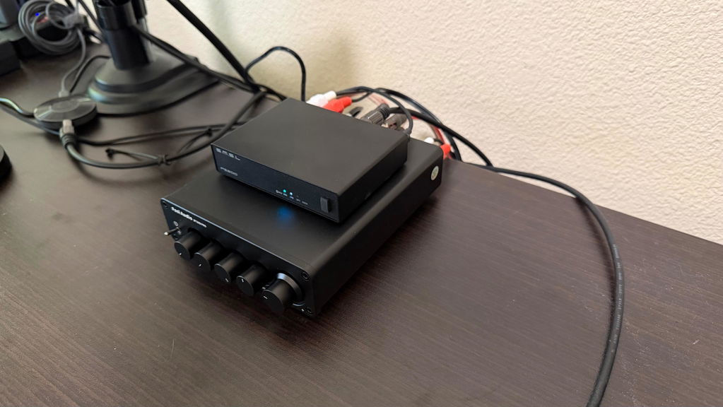

Jeff (United States)
Simple and perfect for my patio speakers

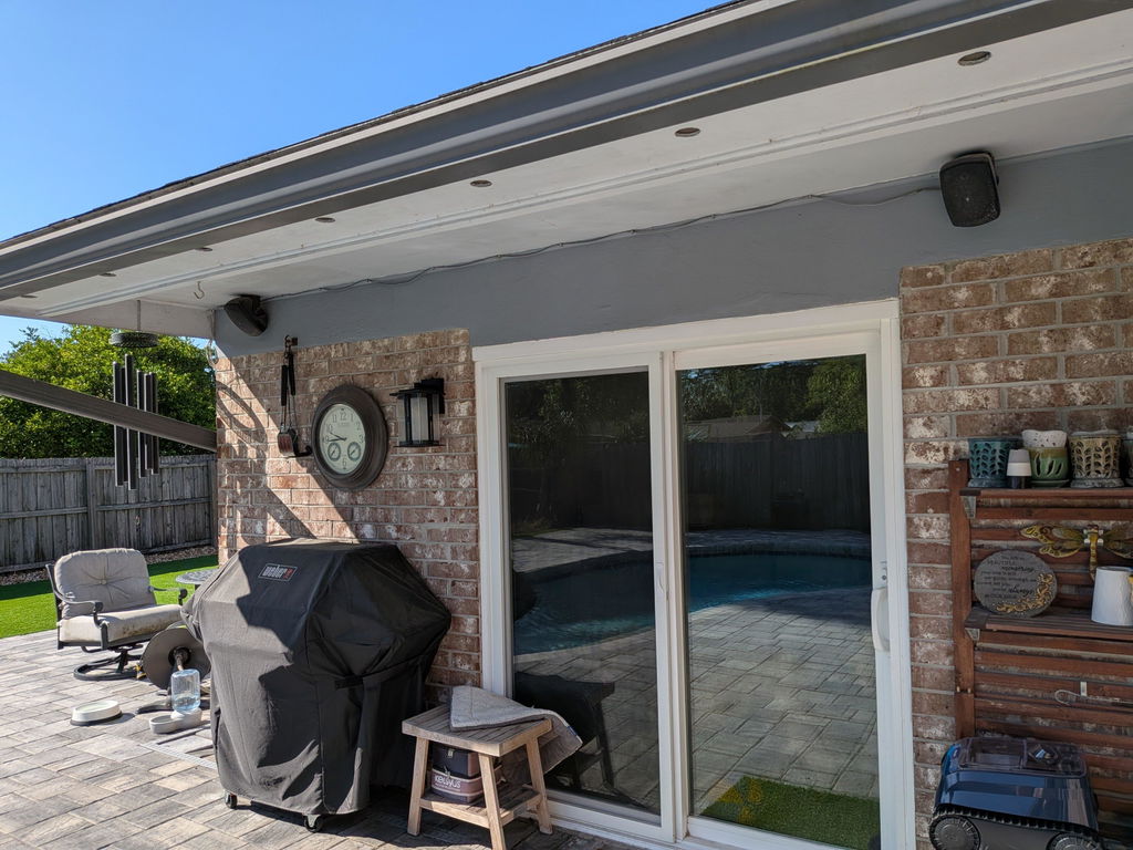

I use this amp to power my outdoor speakers mounted in my backyard near the pool. My source is an old Chromecast Audio or Bluetooth. The set up is so simple and just what I needed. It breathed new life into my old speakers and my backyard never sounded better.

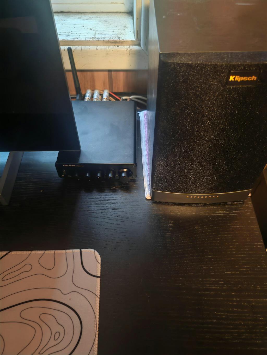

Very clear clean sound plenty powerful... BUT...
Using them with two Klipsch References bookshelf speakers and they sound amazing. However I am also using an 8" 4ohm passive sub and the sub and the sub range never is able to meet the bookshelf speakers. It can push the sub enough but by the time you hear it the bookshelf speakers are drowning it out. You need to be able to turn the two channels down or you have to use a powered sub. If there is a different option you make that can address this or has a more powerful mono channel let me know and I will upgrade.
