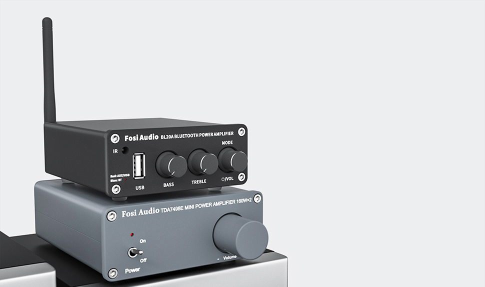

Hi-Fi Mini Class D Integrated Amp
Bring you a perfect music experience
BL20A is a 2-channel 20Watt Power Amplifier, using Class D digital amplifier technology and advanced circuit design. The layout of the amplifier channels are matched to drive most home passive/powered/bookshelf/ceiling speakers.

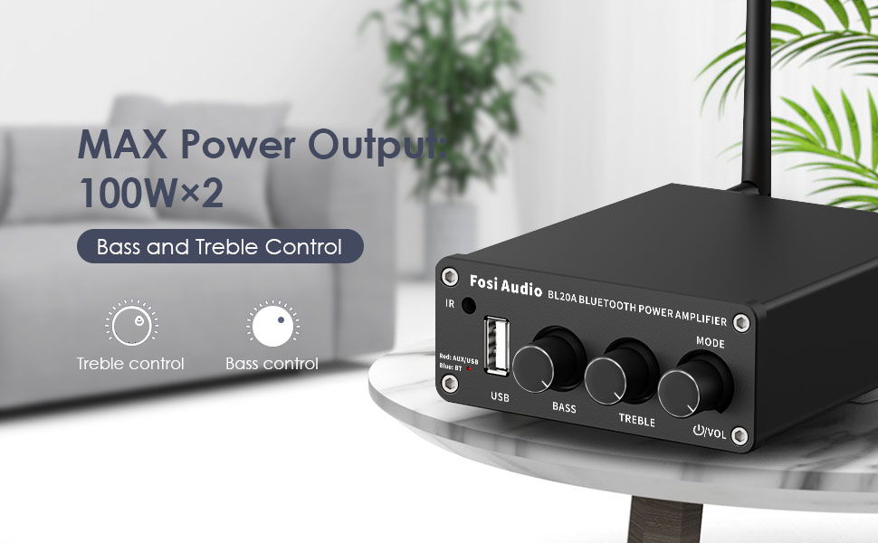

Max Power Output
100 wattΓ—2

β€’ Adjust the treble and bass control of the BL20A to achieve the right tone.
