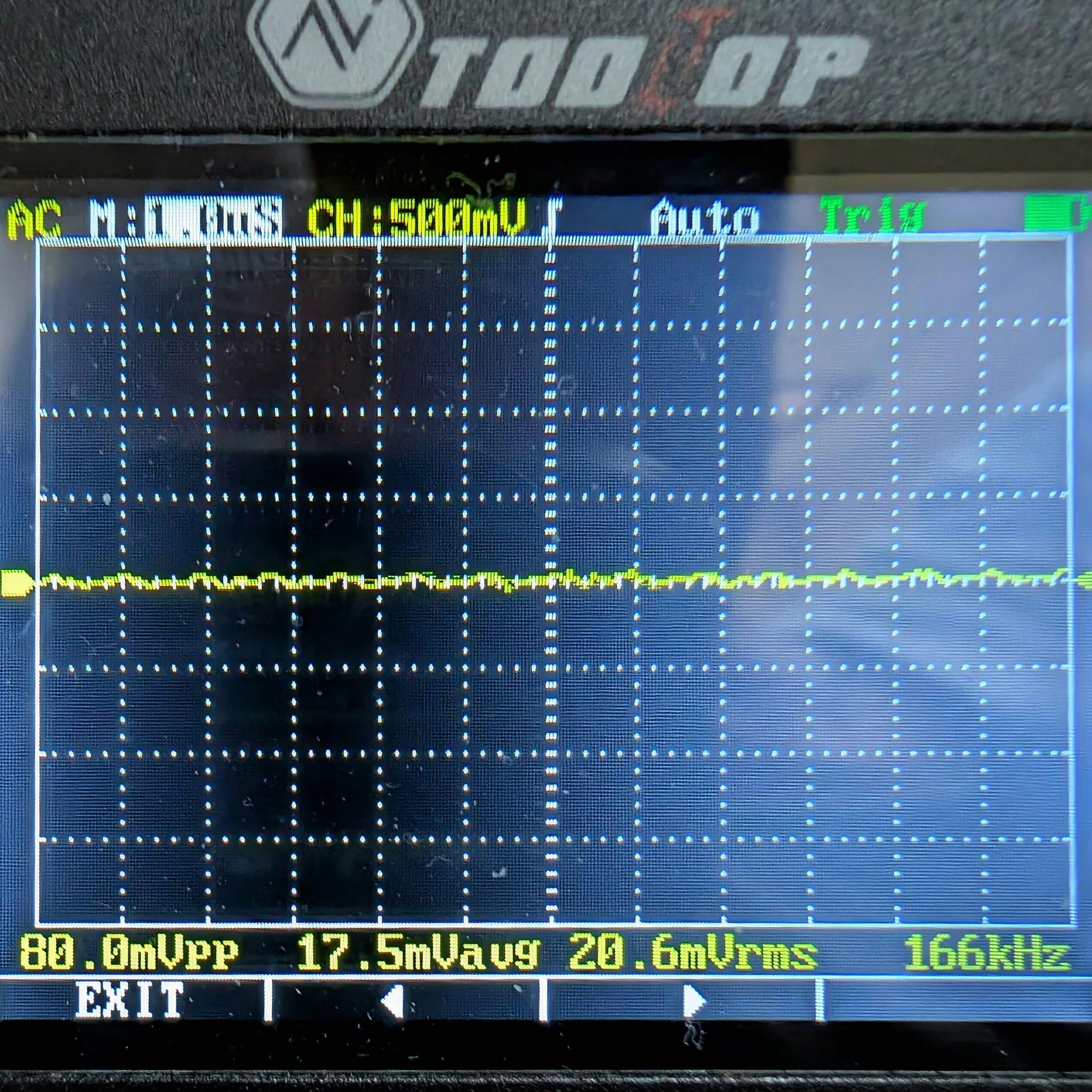

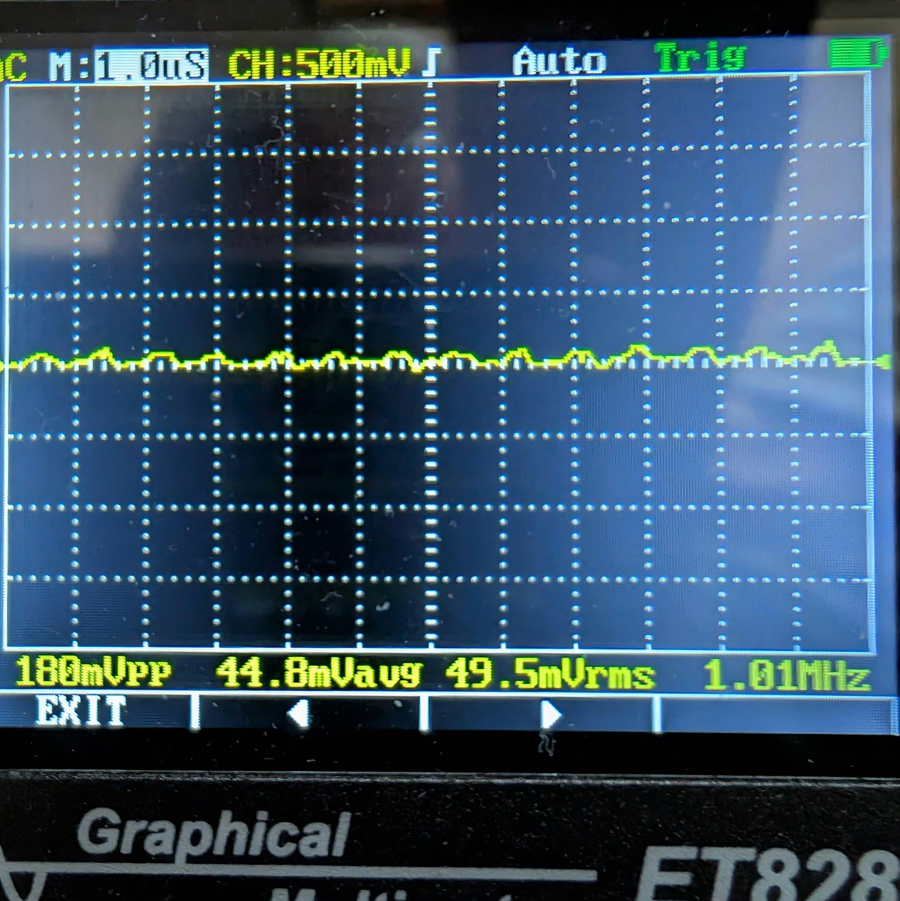

hiwata
Very cost-effective product
I use it with ZA3. I measured what effect this product has. The second photo is without it, the noise is 180mVpp. The first photo is with it, the noise went down to 80mVpp.
In my environment, I was able to reduce noise by more than half. I think this is a very cost-effective product.
