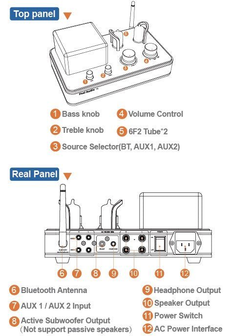

Product Overview & Control Functionsโ€‹

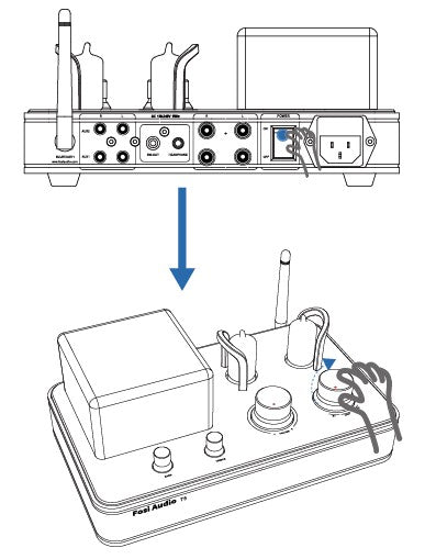

Bluetooth Mode
Step 1๏ผšTurn on the power switch
Step 2๏ผšThe default input setting is Bluetooth mode after booting the T3 Tube Amplifier, and the machine will automatically enter the pairing mode.
