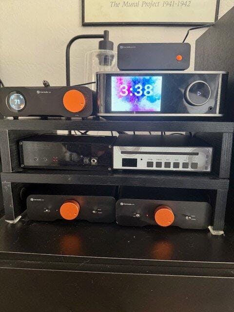

BradS
The hifi world is evolving
I recently set up a ZD3 running ZA3 amps in mono. I upgraded all the op amps. What an amazing setup!! I did not really have to switch the op amps which raised the price a bit. The system is GREAT for not a lot of money in audiophile terms. I added one of the new inexpensive (but good) CD players and a streamer. For around $1000 (Elac desktop speakers) I have a fantastic second system. But none of this would have happened without the ZD3 and ZA3s being so good. And small fitting into a hot little rack. It's great to see this evolution in hifi components.
