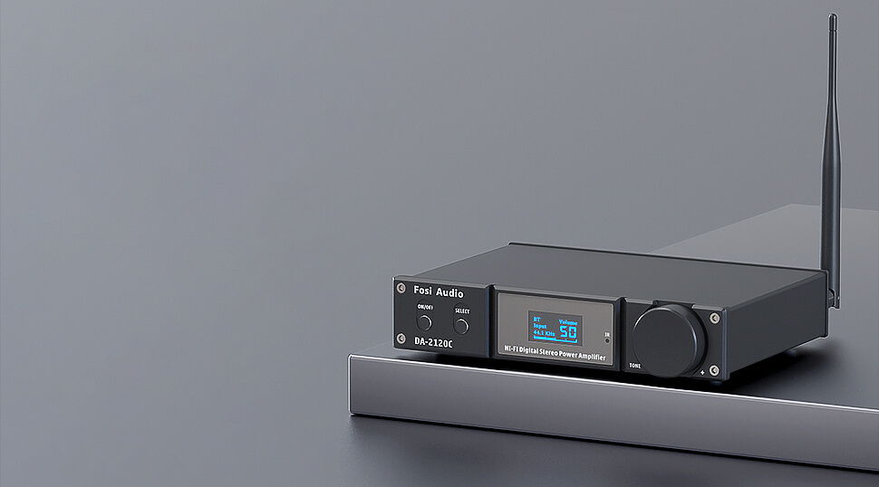

Superior sound quality, highly detailed sound imaging and powerful bass response.
Compact Integrated Hi-Fi Audio Stereo Receiver

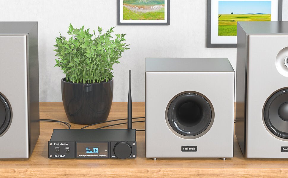

The DA2120C amplifier is a perfect match for both bookshelf speakers, desktop speakers and most powered subwoofers. Itโ€™s 2-channel design provides superior stereo separation, which means you can enjoy true surround sound or have the option to listen to either the left or right channels individually. Its easy-to-use, remote control allows for hassle-free volume adjustment
Discover the World of Crystal-Clear Sound

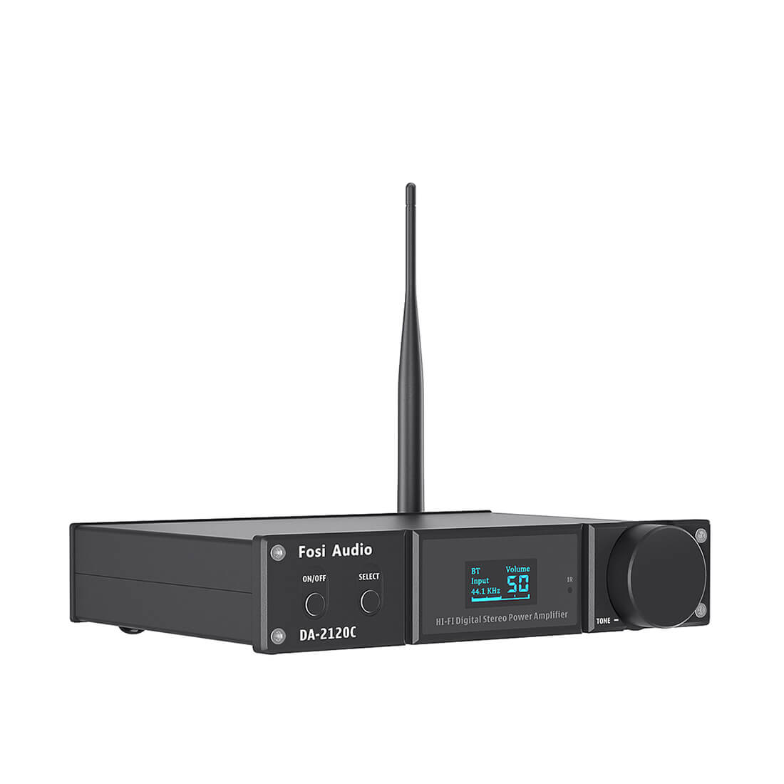

Stream music wirelessly up to 65 ft (20 m) from your iPhone, iPad, iPod and other Bluetooth-enabled devices. With its built-in 6 dBi high gain antenna, Fosi Audioโ€™s amplifier delivers an uninterrupted signal at any location โ€“ even where other receivers may fail.
